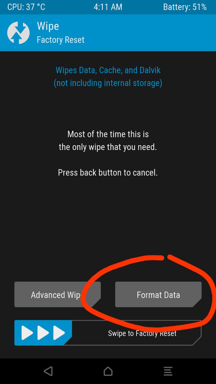

Like in the uploaded image? Your storage shouldn't be encrypted if you formatted data.

yes exactly. If you do that, internal storage won't be touched and it will be still be encrypted with the same password (type password: i can access files via adb, don't type the password, can't access them)

Impossible - if you Format data your storage becomes unencrypted. Try other twrp from this forum or search xda.
ah really? I supposed it was by design. After I flashed the global stable with miflash, it continued to bootloop, i flashed again the twrp, storage was still encrypted with the same password. Then I formatted data, rebooted, and it started. The phone had exactly the same unlock password that was set before wiping it

Just Format data in twrp like in picture above. You have to type "yes" to confirm the erasure. Reboot, then copy your rom to phone and flash it.
tonight i'll try with another twrp because when i do that, storage is still encrypted - maybe it could be the reason it hangs at "unlocked"
