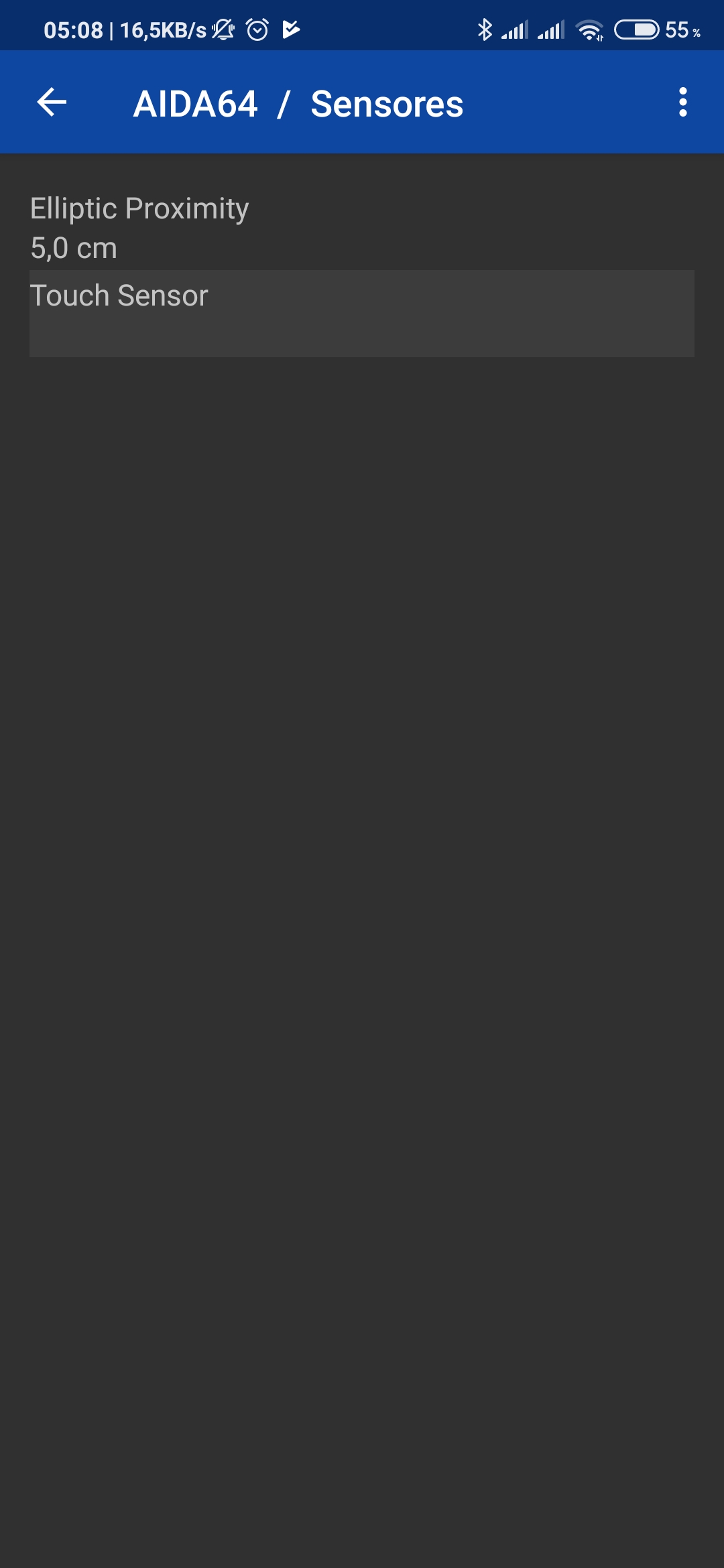

With aida64 app, it only sees 2 sensors...
Managed to get this to work! Somehow updater had wiped persist partition. Fixed it by flashing this persist.img. It is done from TWRP, just need to mount Persist partition first, then flash that image and voila.

Worked. Just had to put my mi account to unlock the phone on first boot and now on aida64 I can see all sensores. Light sensor for example is not at max brightness now.
