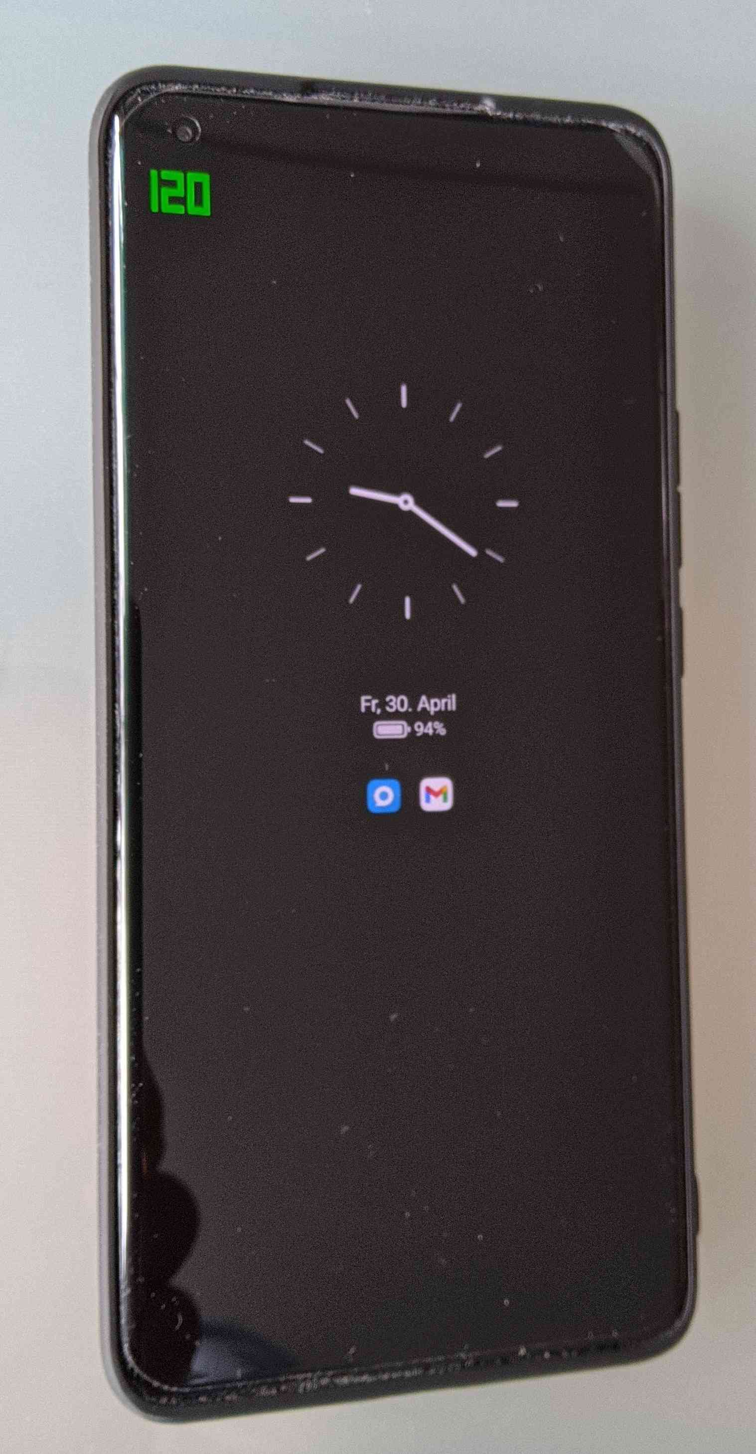

You can check the current refresh rate when you activate the function in the developer Options. The Mi 11 Ultra is capable of dynamically switching between 30, 60, 90, and 120Hz, depending on what's being displayed and how you're interacting with the phone. However in most cases the screen refresh rate remains at 120 Hz. Even on the Always On Display the refresh rate stays at 120Hz. This might explain some battery drain. I guess this is a Xiaomi Software problem but maybe the Xiaomi.eu developers can help to improve the settings?
The funny thing is, it's always 60 for me, except on AOD or lockscreen, so it might be a Bug?
Or super wallpaper needs 120 to work properly?

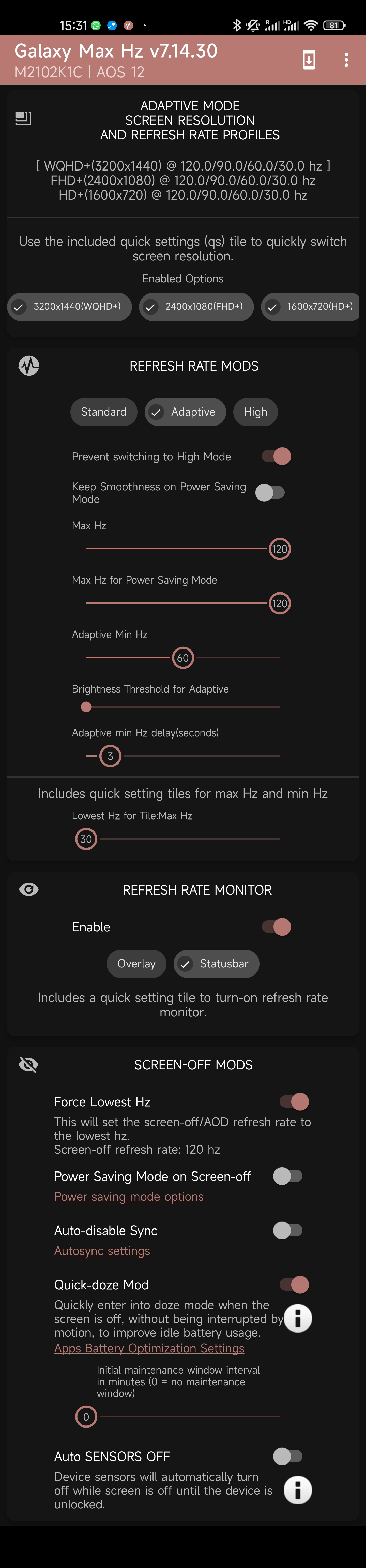

I got in touch with the developer of the app called GalaxyMaxHz, you can find the info about this app in google (I can not post a link because forum doesn't let me, sorry).
After installing this app there was no info about 30hz. I asked the developer to add it to his app, now I can see this option in the app but even when I try to limit the refresh rate of the entire system to 30hz it does not do anything. The app works because I can set it up to switch the refresh rate from 120hz to 60hz after 2 seconds of inactivity, but limiting to 30hz does not work, everything is stuck in 120hz.
Looking forward for any suggestions!
Thank you in advance :)
I got my Mi 11 Pro and started playing around to shed some light on this refresh-rate issue
I'm still on original Chinese ROM 12.5.20 (I'm afraid of issues with bank apps if I unlock it and switch to xiaomi.eu and so far I didn't really have had much troubles with the original chinese rom)
Original setting of the display only allow 60Hz or 120Hz fixed
I installed SetEdit and by setting peak_refresh_rate and user_refresh_rate I can get 90Hz fixed, seems all the times including AoD (using android overlay counter). I also noticed that when I enable Battery Saver mode it is automatically tuned down to 60Hz
Trying now some battery tests to understand how much is the real impact on the battery life, honestly I don't see too much of a difference/improvement going above 60Hz, perhaps I will just keep it to 60Hz if I measure a significant impact on the battery life
Surely it would be nice to have an effective dynamic refresh rate going really down during still or AoD to save battery
I heard that a lot of other android devices even more recent and expensive (Pixel 6 and Samsung 22) have different issues in changing actively the refresh rate, it seems to me that this LTPO technology is still under development and not yet really available/working well on android (perhaps on Iphone13 pros it is ok)
It seems that I found the answer for the issue related with the AOD working in 120hz.
The answer is... the refresh rate counter in dev settings does not work properly.
Just to let you know, I am using miui 13 android 12 chinese stable, no root, locked bootloader.
In a shortcut, the "show refresh rate" in developer settings for some reason does not show in my phone the proper values once the phone goes to aod. The phone with GalaxyMaxHz app active switches to 30hz in aod.
I have no idea why this option does work properly for some users, but for other users (me including) does not work. GalaxyMaxHz also shows wrong values, as far as I was informed the dev of this app is working on a possible solution.
Below I wrote some explaination how I discovered that aod works properly in 30hz.
I connected the phone to pc and in adb terminal I wrote:
adb shell dumpsys display
This command gives a lottt of information, but we are interested just in one line more less on the end of the result. When my screen is in use (I am touching it) and I write this command then I see this result:
"PRIORITY_USER_SETTING_PEAK_REFRESH_RATE -> Vote{width=-1, height=-1, minRefreshRate=0.0, maxRefreshRate=120.0"
When I stop touching it for longer than 3 seconds and I write this command in adb again, I see this:
"PRIORITY_USER_SETTING_PEAK_REFRESH_RATE -> Vote{width=-1, height=-1, minRefreshRate=0.0, maxRefreshRate=60.0"
(so you can see that the GalaxyMaxHz app is doing its job. It switched the refresh rate to 60hz because I did not touch my screen for longer than 3 seconds as I configured it. If you want to know my config check the attachment to this post)
Then the screen tured off and aod got active. Here is the result:
"PRIORITY_USER_SETTING_PEAK_REFRESH_RATE -> Vote{width=-1, height=-1, minRefreshRate=0.0, maxRefreshRate=30.0"
So it works in 30hz! Be sure that the option "Forze lowest hz" is on.
Without the app active I am getting "PRIORITY_USER_SETTING_PEAK_REFRESH_RATE -> Vote{width=-1, height=-1, minRefreshRate=0.0, maxRefreshRate=120.0" during AOD. I can also see that the battery drain is significant without this app.
In my opinion, worth to use it, I am earning at least 1h more of sot per day.
