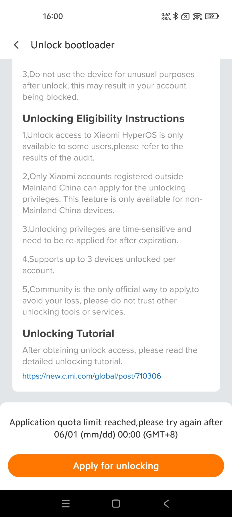

I have a problem with unlocking via Community app. I don't see anybody has this kind of problem.
The phone is Xiaomi 14 Ultra, rom: 1.0.1.0.UNAMIXM
My whole family uses Xiaomi phones. I have my current phone Xiaomi 11 Ultra since it came out, about 3 years ago.
I have a Xiaomi account for 10 years, maybe more. And I have used xiaomi phones since Xiaomi Redmi 3. The reason I use them is because I can unlock them and use xiaomi.eu roms.
I have tried 3 accounts of mine, and I get the same error on every one of them. I don't want to wait 6 months.
Any solution to this?
It is not six months, but only 1 day until the next attempt. 6=month (m) and 1=day(d). So on June 1st, 2024. You misinterpreted it .
