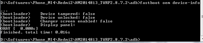

Although Redmi 2 is an old phone and I thought that it has the bootloader unlocked...guess what:
command: fastboot oem device-info
