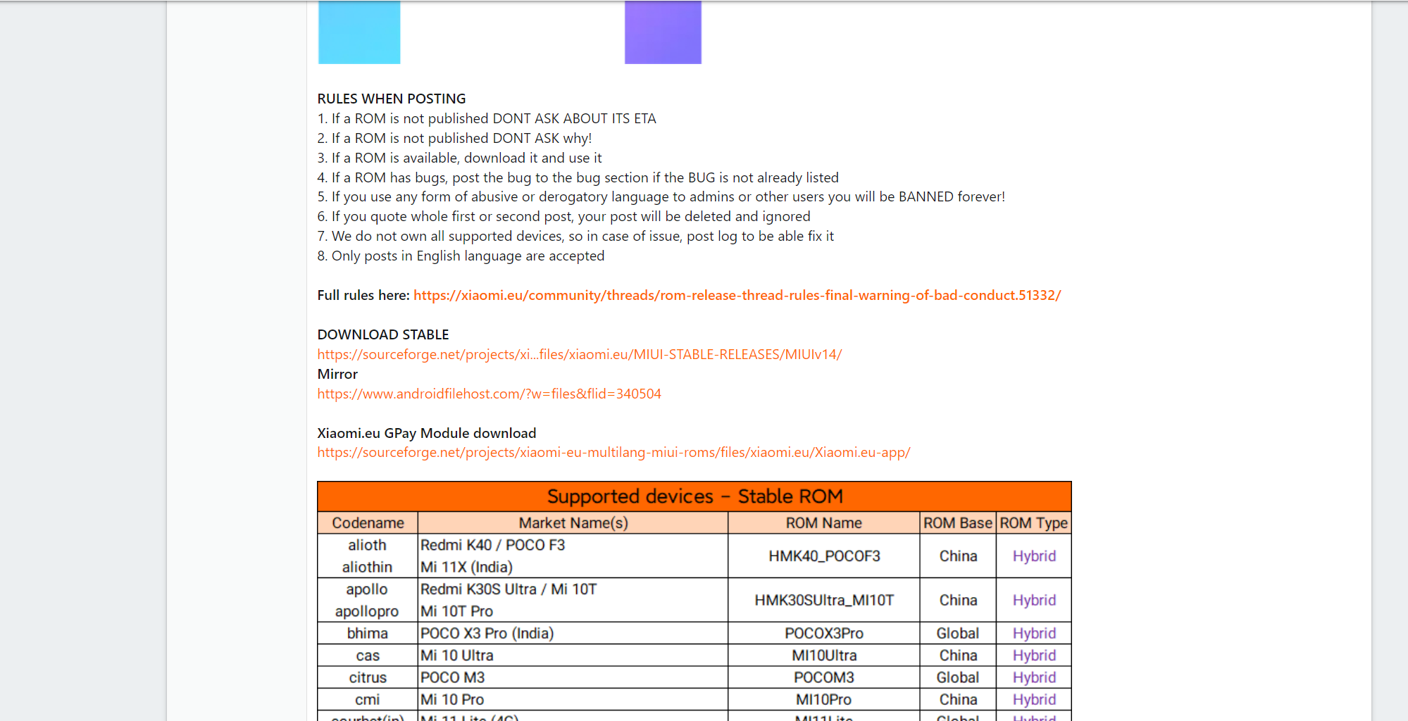

Everything will work properly and Gpay?

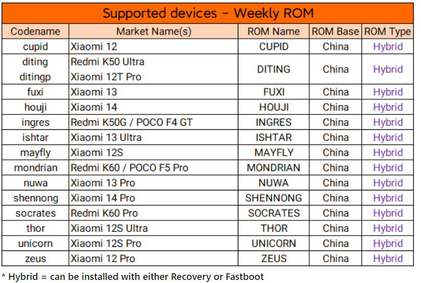

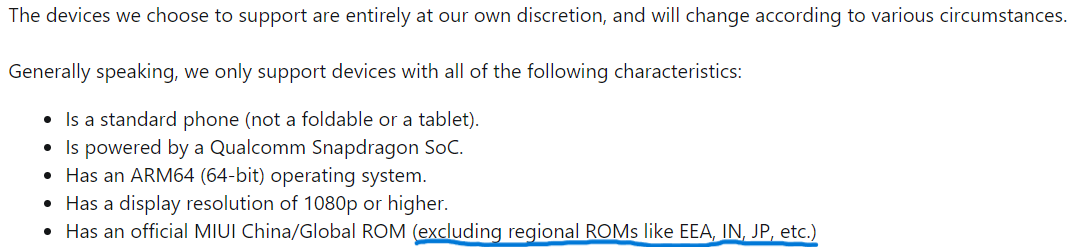

As far as I can see, Xiaomi 13 lite is not supported - at least I don't see it within the list of HyperOS devices:

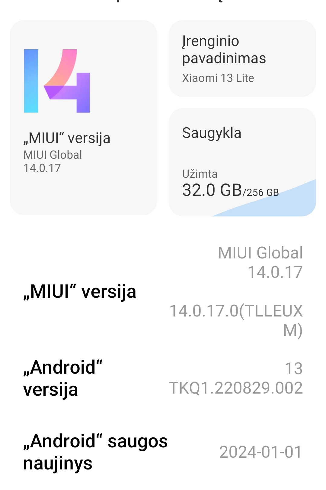

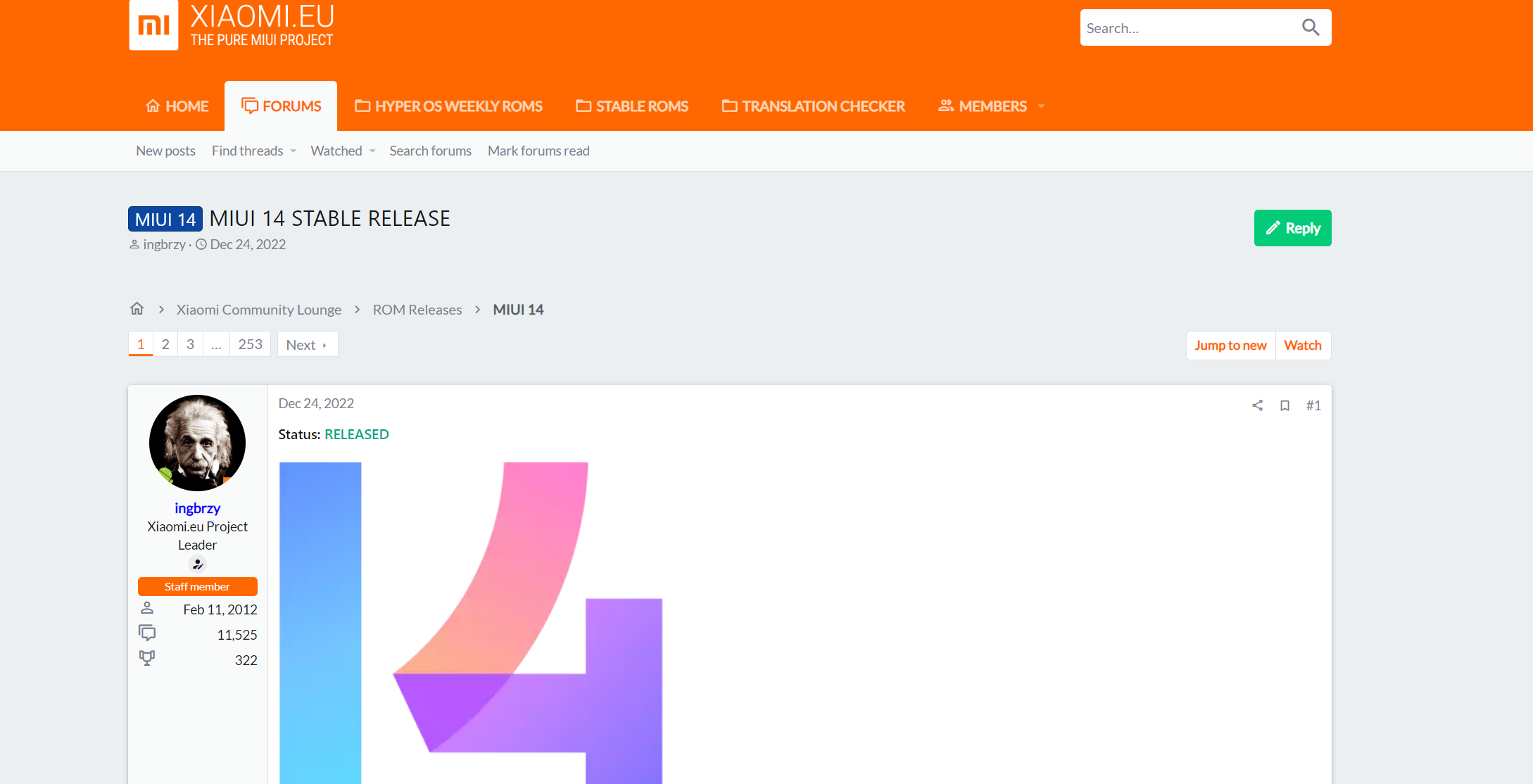

It's very strange! Where did you take the screenshot from?
This is the thread for HyperOS stable release and I don't see Xiaomi 13 lite either...

this is not hyper os

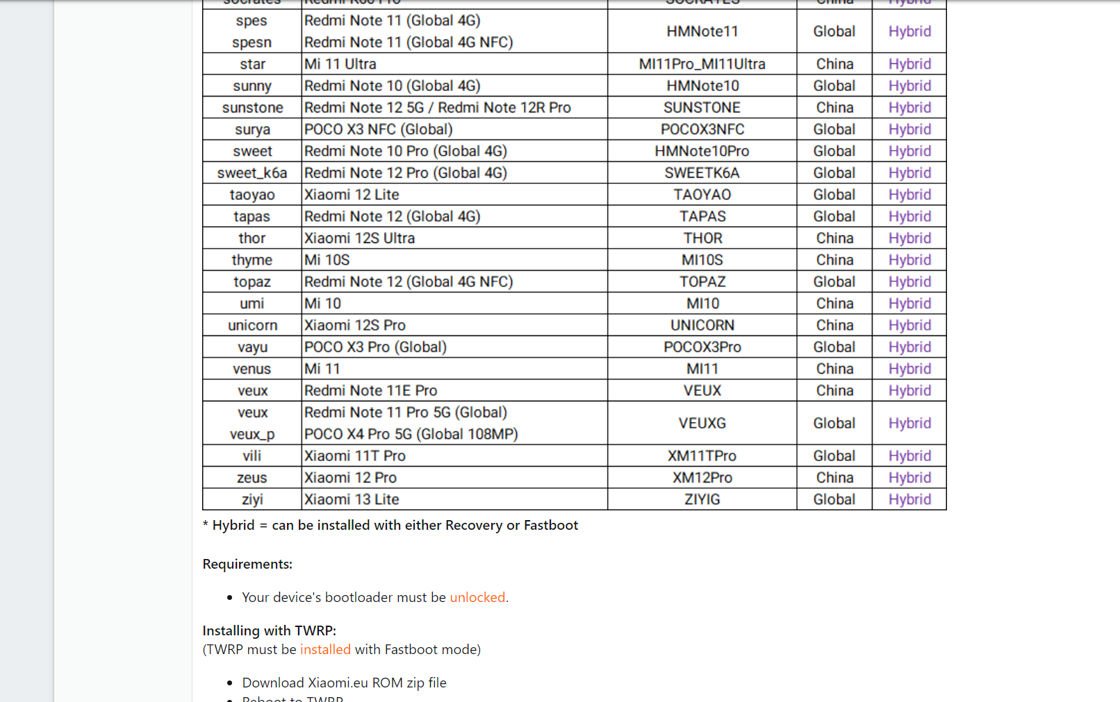

Ah okay, sorry - my mistake.
In this case yes - it will be compatible. But have in mind the latest stable MIUI 14 for your device is 14.0.5. as far as I can see, while the current version on your phone is 14.0.17. This means you have to downgrade, meaning you have to delete all your data from the phone. If you would like to proceed, make sure you backed up your data.

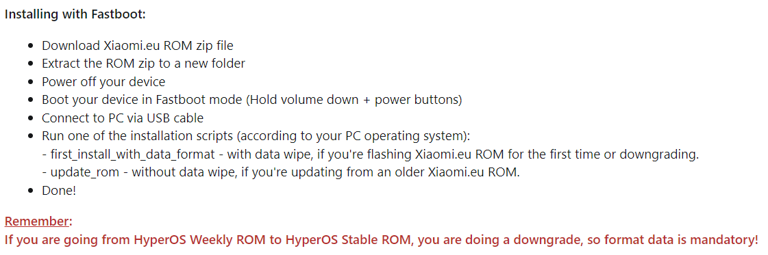

Then, you need to unlock your bootloader, download the rom and decide how to install it - easiest way is via fastboot. Within the thread you could find the steps, but they seems like this:

You cannot compare CN ROM numbering with Globat ROM. A lower number may not mean an older version.
During the first installation, all data must be deleted anyway, as stated in the instructions.
And Everything will work properly esim, Gpay?
I can't say, as I don't own this version of the device. You could try searching the thread for stable version for issues with eSIM/Gpay, reported by users.
