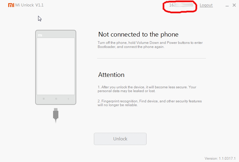

Had this same problem, just on phone use "other ways to sign in" an then use your Mi Account ID.
Mi account ID is in top right corner of Mi Unlock Software.

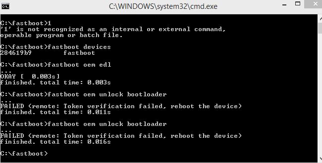

hello anyone could help me? I have a Mi4c MIUI 8.9.9.1 Beta, ans when i try to unlock the xiamo appears a message Couldn´t verify device - current account is different from account info on the device but is the same. I have already login into i.mi.com and find device and seems all ok but when i try to unlock always the same message. Anyone to help? @GoGaow
I have used also fastboot but not success...
if i install aa stable china version Version: V7.5.3.0.LXKCNDE it will help??
