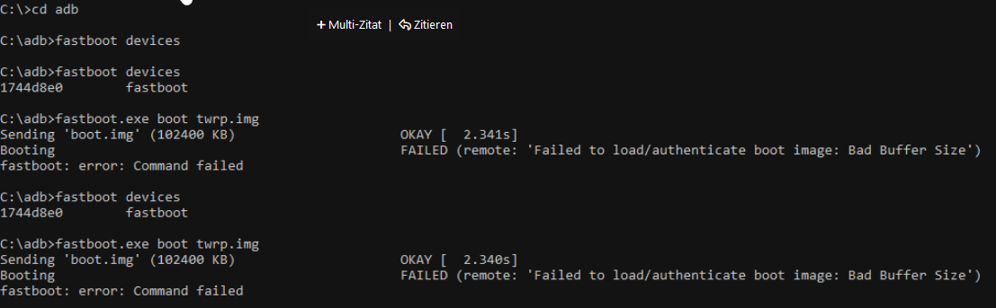

have a question for the experts :)
I wanted to update my Mi12 to the new stable.
I went into fastboot as usual and wanted to boot into TWRP via ADB.
I loaded the current one (twrp-3.6.2_12-v6.3_A12-cupid-skkk.img)from the Xiaomi.eu site and then renamed it to TWRP.
Then I did the steps as seen in the CMD.
After that, nothing worked. (Sweat). Have the error googled but found nothing.
Why does not work, where is the error, but has otherwise always worked?

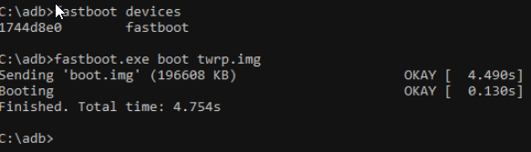

Then I searched for an old version and found this. twrp-3.6.2_12-v3.9_A12-cupid-unofficialtwrp
With that it booted back into TWRP and I was able to install the stable rom.
With the version it has then booted back into TWRP and I could install the stable Rom.

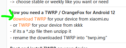

have found the error, I loaded the TWRP from the site Xiaomi.eu and there is nothing about boot and REC.
On the other side of skkk that there is boot TWRP and REC TWRP.
No idea what then that is for a TWRP on the linked page of Katerpanne.

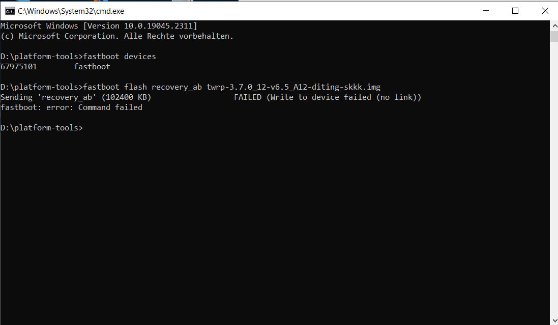

Unfortunately the command works
fastboot flash recovery_ab twrp-3.7.0_12-v6.5_A12-diting-skkk.img
as shown in the picture, does not work.
Please help me!
Many thanks

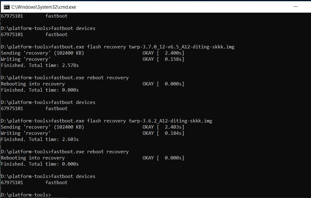

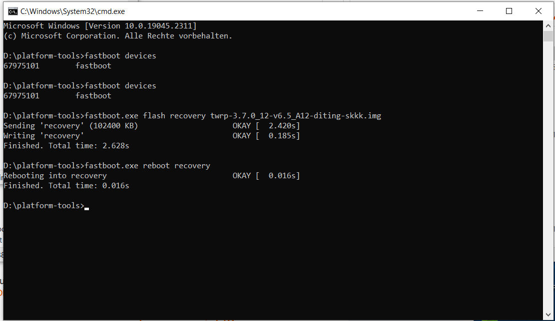

Now I have also tried the two TWRP via
fastboot.exe flash recovery twrp-3.6.2_A12-diting-skkk.img
oder
fastboot.exe flash recovery twrp-3.7.0_12-v6.5_A12-diting-skkk.img
fastboot.exe reboot recovery
to install them.
It also worked, but I can not get out of the FASTBOOT.

Unfortunately TWRP does not start for me.
Did you not lose any data?
Yes, after I performed "fastboot.exe reboot recovery" the recovery booted up for me. I didn't lost any data because I didnt wiped the phone. I just flashed the rom again. To be fair I had the xiaomi.eu 13.0.11 rom installed before.
Can you please help me further?
I have executed the commands (according to my image 5).
But then was further only FASTBOOT to see!
So once again
and wait?
Reboot the phone, it'll automaticly boot in FASTBOOT, after that connect it to a PC and perform the "fastboot.exe flash recovery twrp-3.7.0_12-v6.5_A12-diting-skkk.img" command. After that is done you perform "fastboot.exe reboot recovery". You should end up being in TWRP.
made but I continue to see only FASTBOOT on the screen of my smartphone
