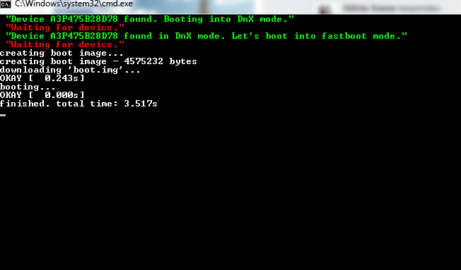

I don't know what I need to do? nothing happens. Do I need to write some command?
When your device booted into fastboot mode, have a look into device manager. Maybe something wrong with driver. Then update drivers from Drivers/Xiaomi subfolder inside the Toolbox.
