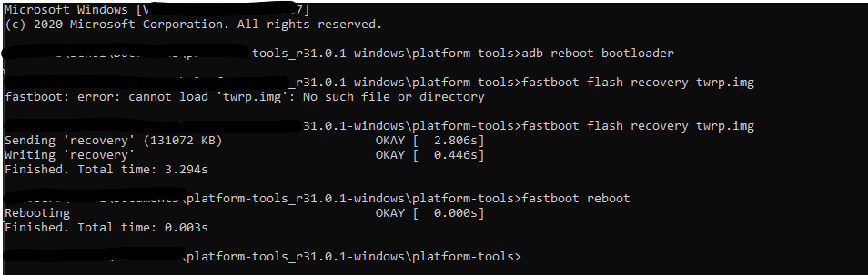

When trying to access TWRP I still end up with "mi-recovery 3.0".
Verified my installation of TWRP and it was okay.
35972
I must be missing something
edit!: got an info on the TWRP thread, andswitched to https://forum.xda-developers.com/t/recovery-3-5-1-unofficial-twrp-xiaomi-mi-10-pro-cmi.4241711/
worked like charm, now about to try to install that Rom/
Do not "fastboot reboot". ;)
After "fastboot flash recovery" command, hold " Vol+" and "Power" buttons simultaneously until you see the TWRP splashscreen.
