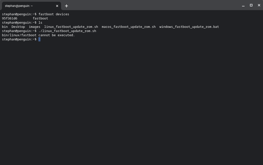

Spacman
Jun 7, 2021
12
@Igor Eisberg maybe know what to do?
