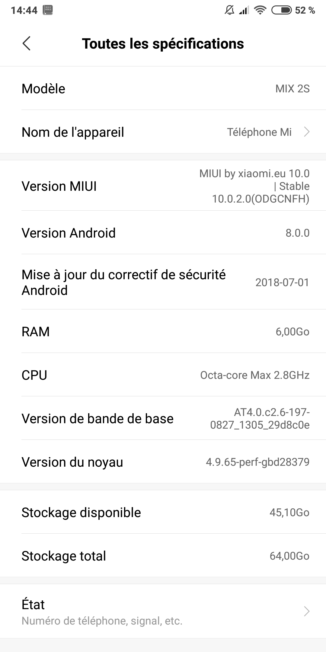

Thank you for fast answer !
How can I know that ? It's a Global version, 6GB/64GB

Take a look on the back of your device. It should look like....... XA or....... XE
