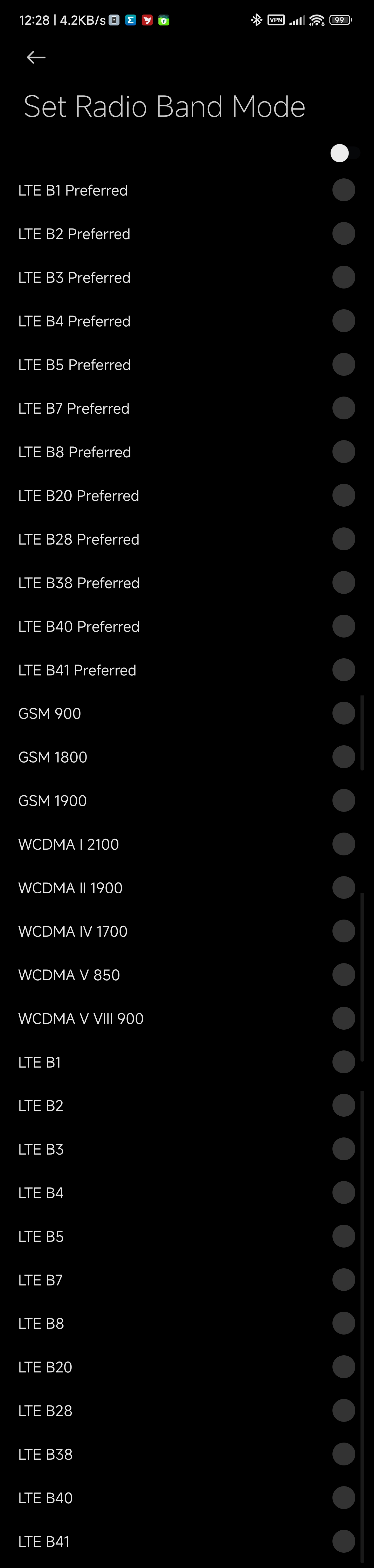

Using sika524's QuickShortcutMaker, I can get this band selection page:
No idea if this is just a static list or actually supported band list. Cannot try without having an operator using that particular band.
So one more time and for the last time. Band support is limited by HW and cannot be accessed by any SW. In 12 years, no one has succeeded.
