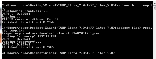

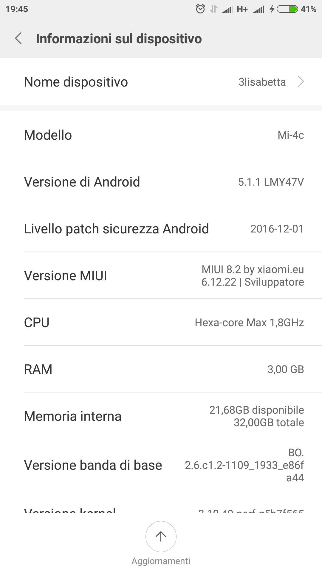

I try to do it and in the pictures the result............
I think not happen.......... Cattura1.PNG Screenshot_2017-02-25-19-45-00-321_com.android.settings.png

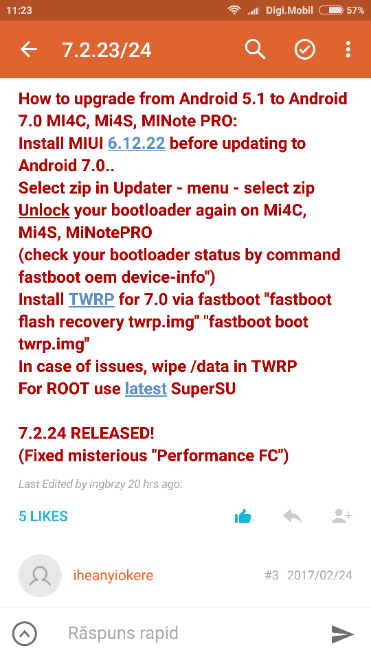

How to upgrade from Android 5.1 to Android 7.0 MI4C, Mi4S, MINote PRO:
Install MIUI 6.12.22 before updating to Android 7.0..
Select zip in Updater - menu - select zip
Unlock your bootloader again on Mi4C, Mi4S, MiNotePRO
(check your bootloader status by command "fastboot oem device-info")
Install TWRP for 7.0 via fastboot "fastboot flash recovery twrp.img" "fastboot boot twrp.img"
In case of issues, wipe /data in TWRP
For ROOT use latest SuperSU
7.2.24 RELEASED!
(Fixed misterious "Performance FC")
Hi, I did all the list...........but nothing happen.
There's something wrong, but I dont undestand
I have yet android 5.1.1 and rom 6.12.22..............

I'm guessing you don't have TWRP installed yet. From the image you posted you tried to install TWRP 3.0.3.0, but this works only if you have android 7.0 installed, it doesn't work under android 5.1.1.

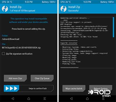

9. select the file and install: see the uploaded image
10. two red errors will appear, but the image will be installed

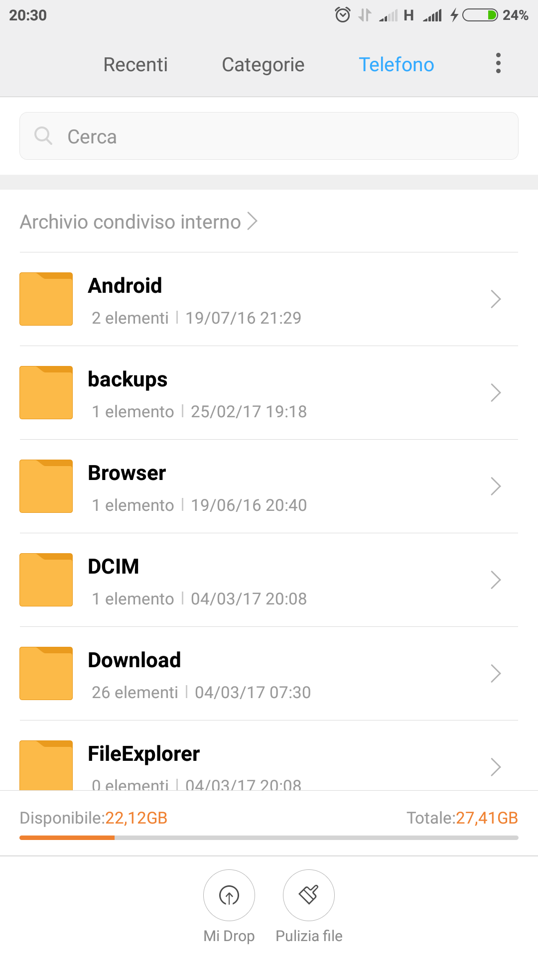

2- When I connect the phon with pc I'm not be able to see all foldres as before........(see pic)
Now it ask me USB for MTP or PTP,
Can you help me another time??
Many thanks
