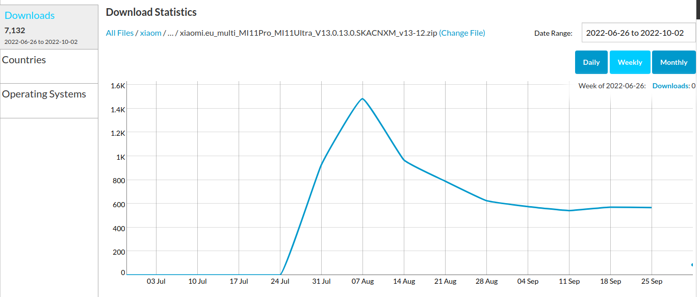

Strange..
ROM version 13.0.13 has more than 7k downloads..
So please explain step by step what you did and we will tell you where you broke it..

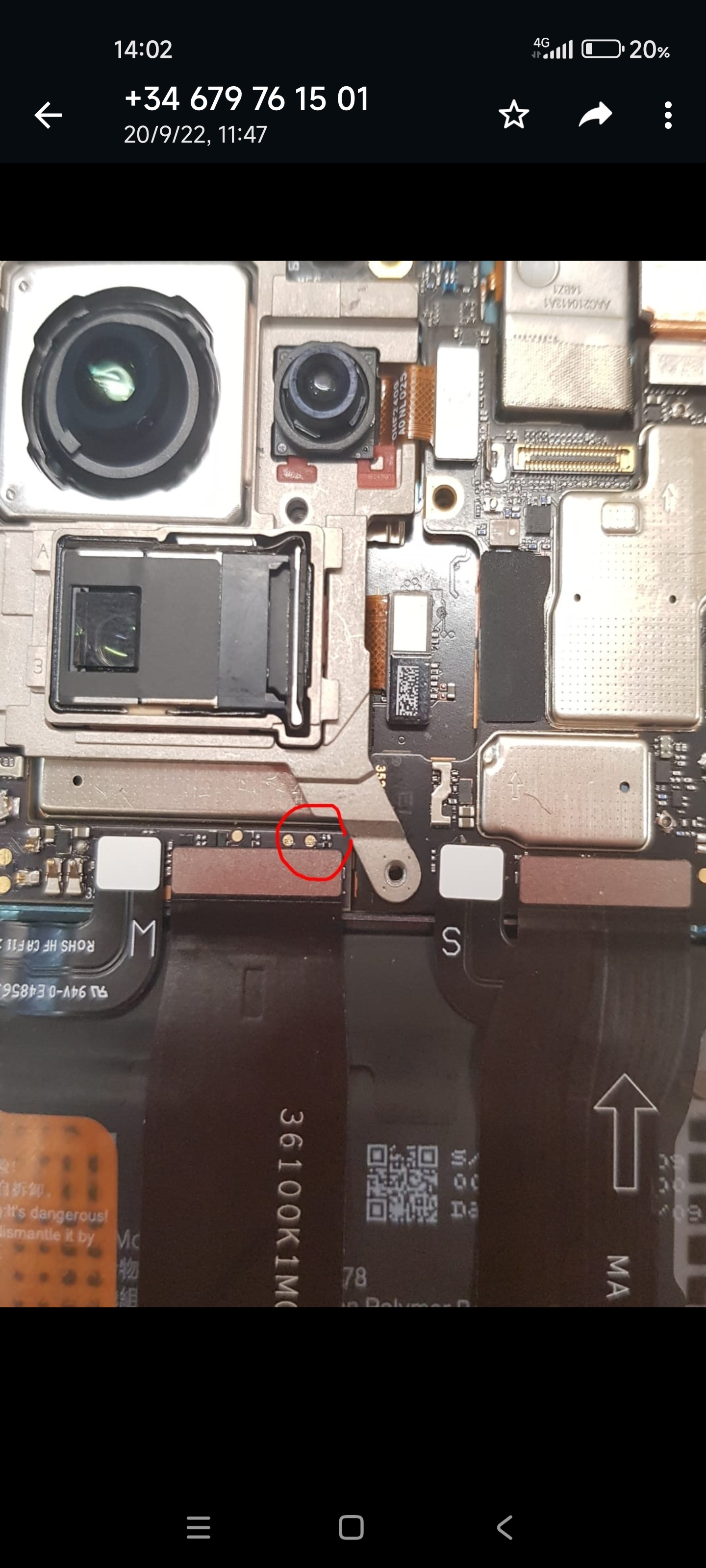

Have you tried to repair it? You can do a "test points" checking with device connected to PC via USB. If device is detected, a new ROM can be flashed in EDL mode.
I did it, but flashing was not possible: motherboard memory damaged.
To do the "Test point" checking, back cover must be opened. It's not easy but it can work...

How did you do the "testing" by opening the back case of the phone? My Xiaomi Mi 11 died also with xiaomi.eu (weekly).
How does the PC recognise it? What did you do when you opened the phone? What programme did you use?
By the way, you can use a file called firehose to access EDL (for Hardbrick phones).
I can't find that file (firehose), only people doing business in youtube videos where they give their telegram and offer service through teamviewer.
Remove back case, with hot air ( using a Hairdryer), then connect both test poins with a metalic gripper and connect device with PC via usb
