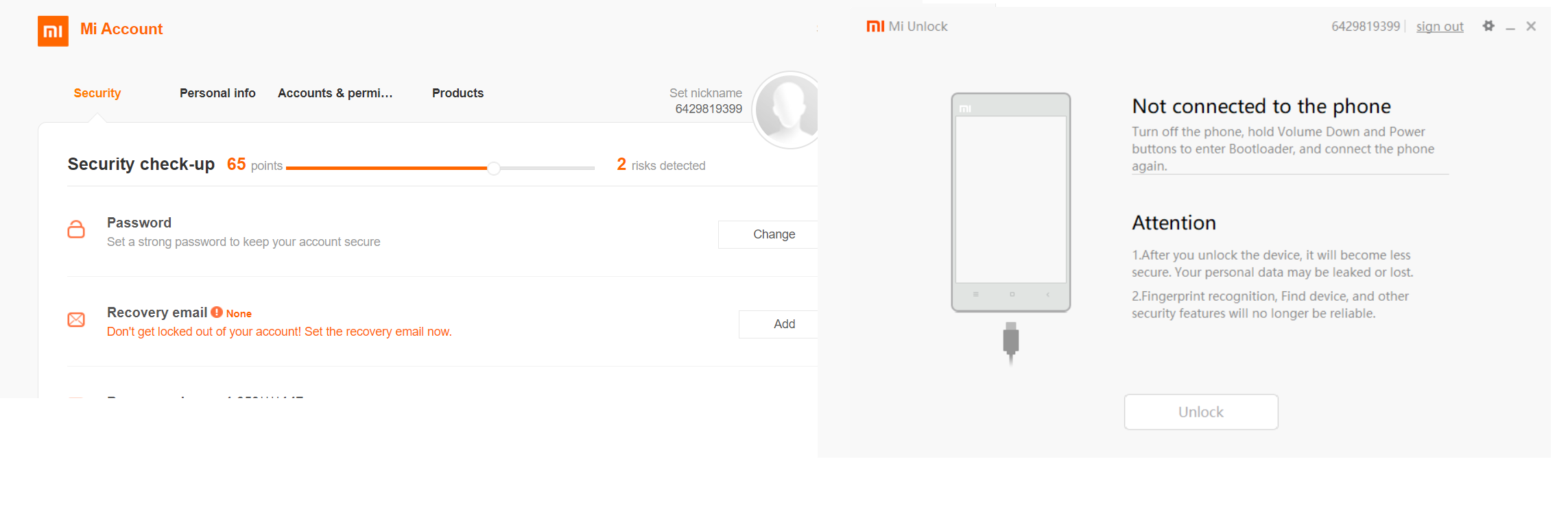

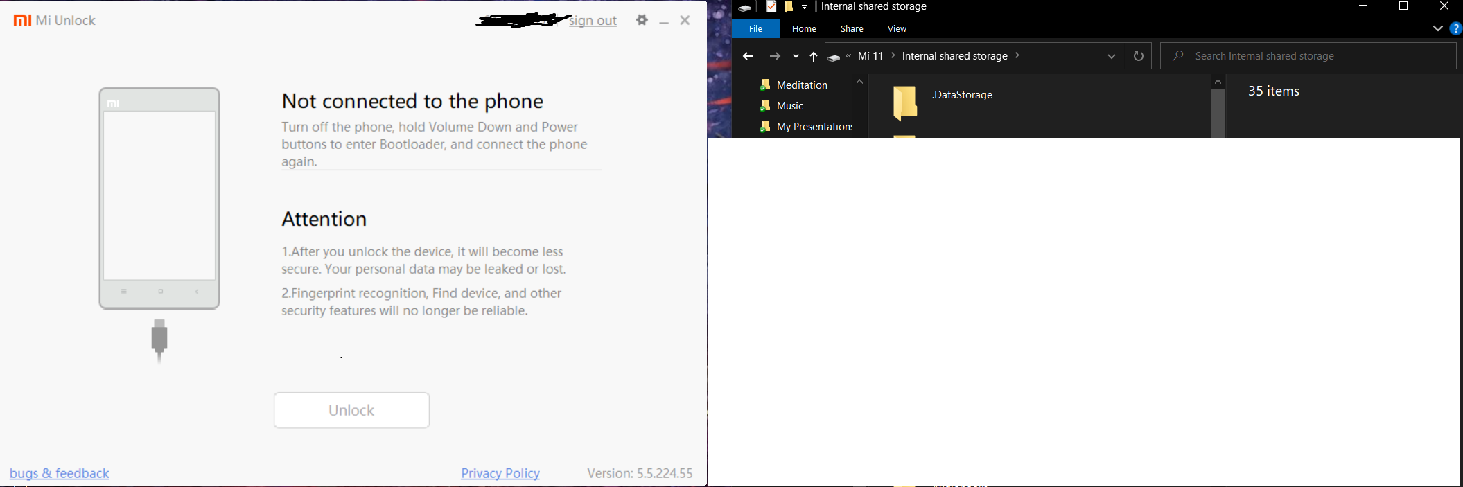

I went through the guides, allowed all the USB options, connected to a MI account, and downloaded the most recent MI Unlock... but it's stuck on "not connected" no matter what I do.
Attached pic shows it as it's on and connected, but it remains as such even in fastboot (starting with power + volume).

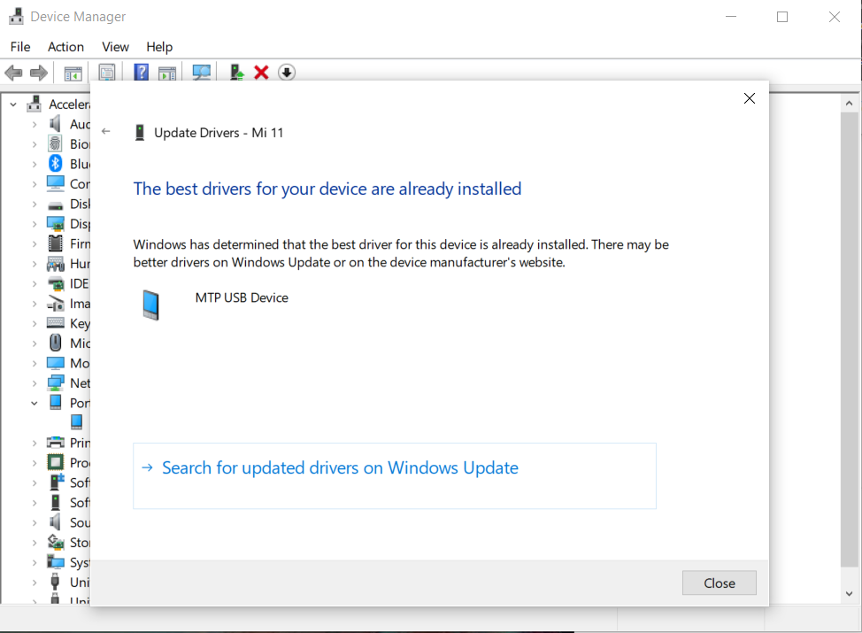

Already installed it seems. I installed the ones that came with the Mi Unlock software.

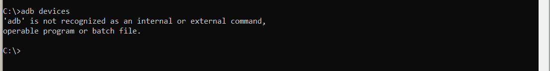

You can find out easily if you did everything right. Start in terminal with "adb devices". If you see code of your device, everything is in order. Just approve the computer on the phone. And when you boot to fastboot, first make check with "fastboot devices".
Correct response is firm sign that you have everything ok.
Where do I start cmd to type adb devices in?
Fastboot devices (cmd in the mi unlock folder with fastboot in it) returns nothing with phone in fastboot.

I have this all. :\ And yeah, when connecting the phone, there's a popup with "transfer files", "do nothing", and some other option (maybe transfer pics).
I can see phone files from windows using explorer.

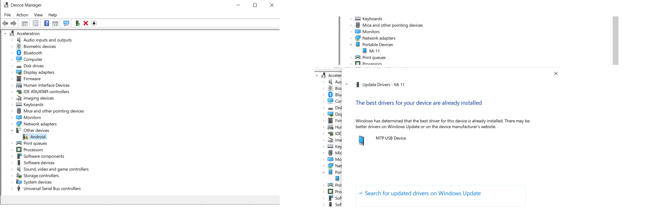

That's normal why booted up, but in Fastboot?
In fastboot I get nothing and device manager shows the left side.
(Right side is phone booted up and accepting files from Windows)
Hmm, im pretty sure that's due to the lack of adb drivers, did you try “adb devices“ from cmd while connected in Fastboot as mentioned?
That's not enough. You must have adb and fastboot installed in order to unlock bootloader. From the link i sent you or from anywhere else.
I installed those and Windows tells me the above (no better drivers) if I try again.

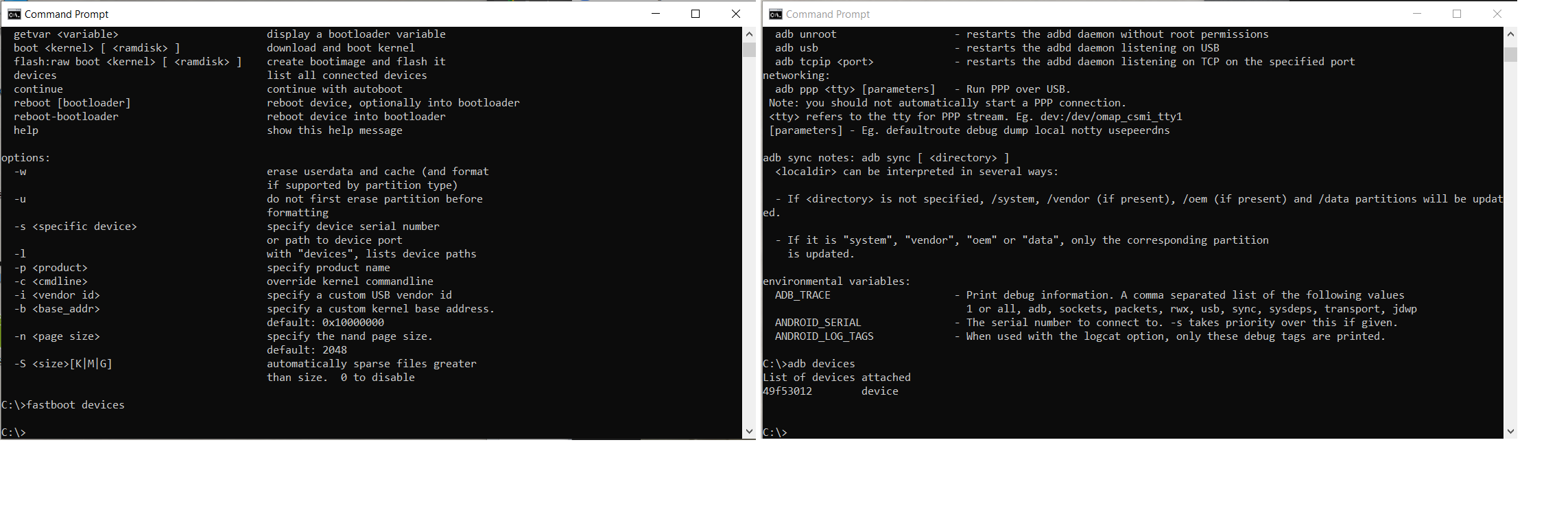

Thanks piskr. I don't know how that doesn't appear in any of the tutorial's I've seen, text or video. Now ADB finds my phone, but fastboot does not.

Crap, I posted the wrong image. Sorry!
Good! So just ensure usb debugging is enabled and mi unlock tool should give you some information.
You can login to the tool?
It should come back with wait time.
Your MI account is bond to the phone?
Something like that:
Keep trying!
Sent from my Mi11
Got a Mi account on the phone and same account on the tool. But it doesn't recognize the phone. Also, fastboot doesn't seem to recognize the device.... ?
35375
Okay, but your screen from cmd says otherwise, there is a device listed.. weird...
What I would do, start mi Unlocker as you did.
Enter fast boot, attach phone, should be recognized after Windows made a noise.
