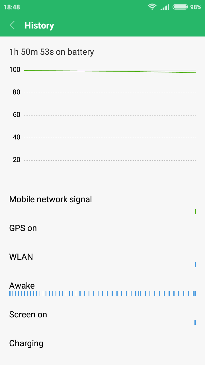

I did a total clean install. Wiped everything and installed 7.9.22 dev. I only did the install process with adding google and mi account and nothing more. Charged the phone to 100% than put in airplane mode. As you can see on the picture 2% drain after a little less than 2 hours. No mobile network, no gps, no wlan, no screen on but constants awake.
Please give me some solution to this!
