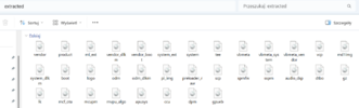

Xiaomi is making a fool of themselves by not having a Hyperros 3 ROM for the Xiaomi 13t. Based on an internal OTA zip file that can't be installed without an authorized account, I created a ROM for a phone with an unlocked bootloader that can be flashed via Fastboot. As we know, it's not easy—but it can be done:) I extracted the images of each partition from payload.bin and created a script for flashing on an unlocked bootloader, and it works. I don't know if you can lock the bootloader later—I wouldn't do that because it's a modified official ROM. But it works for fun. If anyone wants instruction below:
1) download rom:https://bn.d.miui.com/OS3.0.1.0.WMF...ll-OS3.0.1.0.WMFIDXM-user-16.0-c06fa9f8a0.zip
2) Extract it, add to the same folder 7zip all files, add to this folder too: https://github.com/ssut/payload-dum.../payload-dumper-go_1.3.0_windows_amd64.tar.gz unzipped
3) make bat file in this folder extract.bat:
@echo off setlocal echo === Xiaomi payload.bin extractor === where 7z >nul 2>nul if errorlevel 1 ( echo Brak 7-Zip w PATH. Zainstaluj 7-Zip albo dodaj 7z.exe do PATH. pause exit /b 1 ) if not exist payload-dumper-go.exe ( echo Brak payload-dumper-go.exe w tym folderze. echo Pobierz Windows release z GitHub: payload-dumper-go pause exit /b 1 ) if exist payload.bin ( echo Znaleziono payload.bin ) else ( echo Szukam ZIP-a... for %%f in (*.zip) do ( echo Wyciagam payload.bin z: %%f 7z e "%%f" payload.bin -y goto :got_payload ) ) :got_payload if not exist payload.bin ( echo Nie znaleziono payload.bin ani ZIP-a. pause exit /b 1 ) mkdir extracted 2>nul echo Rozpakowuje payload.bin... payload-dumper-go.exe -o extracted payload.bin echo. echo Gotowe. Obrazy sa w folderze: extracted echo. dir extracted pause
4) in fastboot run from extracted folder:
fastboot flash boot boot.img fastboot flash vendor_boot vendor_boot.img fastboot flash dtbo dtbo.img fastboot --disable-verity --disable-verification flash vbmeta vbmeta.img fastboot --disable-verity --disable-verification flash vbmeta_system vbmeta_system.img fastboot --disable-verity --disable-verification flash vbmeta_vendor vbmeta_vendor.img fastboot reboot fastboot
then
fastboot flash system system.img fastboot flash vendor vendor.img fastboot flash product product.img fastboot flash system_ext system_ext.img fastboot flash mi_ext mi_ext.img fastboot flash odm odm.img fastboot flash vendor_dlkm vendor_dlkm.img fastboot flash system_dlkm system_dlkm.img fastboot flash odm_dlkm odm_dlkm.img fastboot erase metadatafastboot reboot
voila - you has INTERNAT TEST VERSION hyperros 3 on android 16, xiaomi 13t :)
