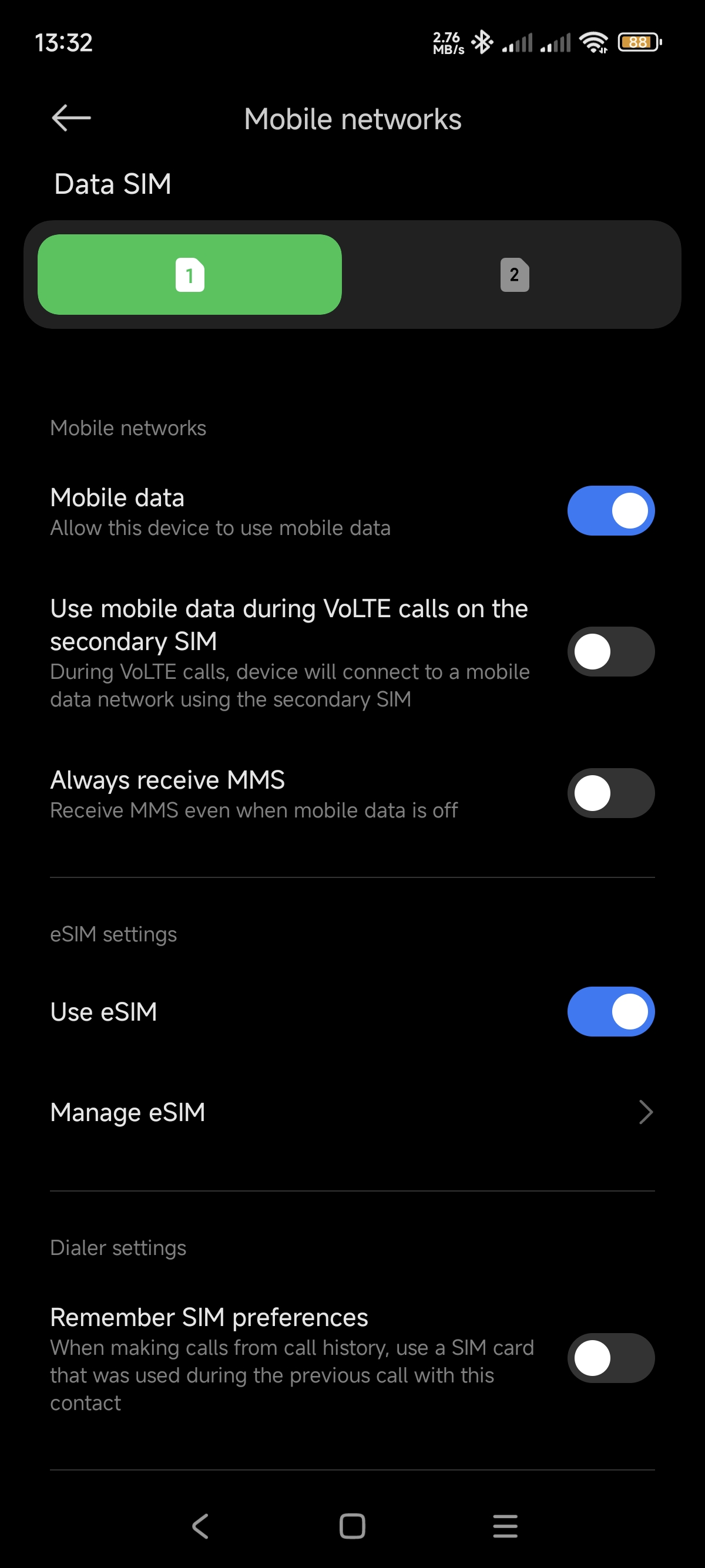

The “Manage eSim” menu in the settings cannot be opened. I have the global Xiaomi 14 version with this patch

Too much "noise" in your log. It looks like you're turning eSIM on and off, instead of just trying to open "Manage eSIM" once and stop logging.

@Kacper Skrzypek the global modem files are packing the next weekly ROMs or we need to flash it separated?
For the time being, you'll have to apply the "Global Modem patch" subsequent to every ROM-Update you're flashing, unfortunately.
To make sure that you're on the latest Modem/Baseband Version, you can download the latest modem.img and modemfirmware.img for Global or EEA from here.
Not sure which version to choose? Then please read the clarification here:
