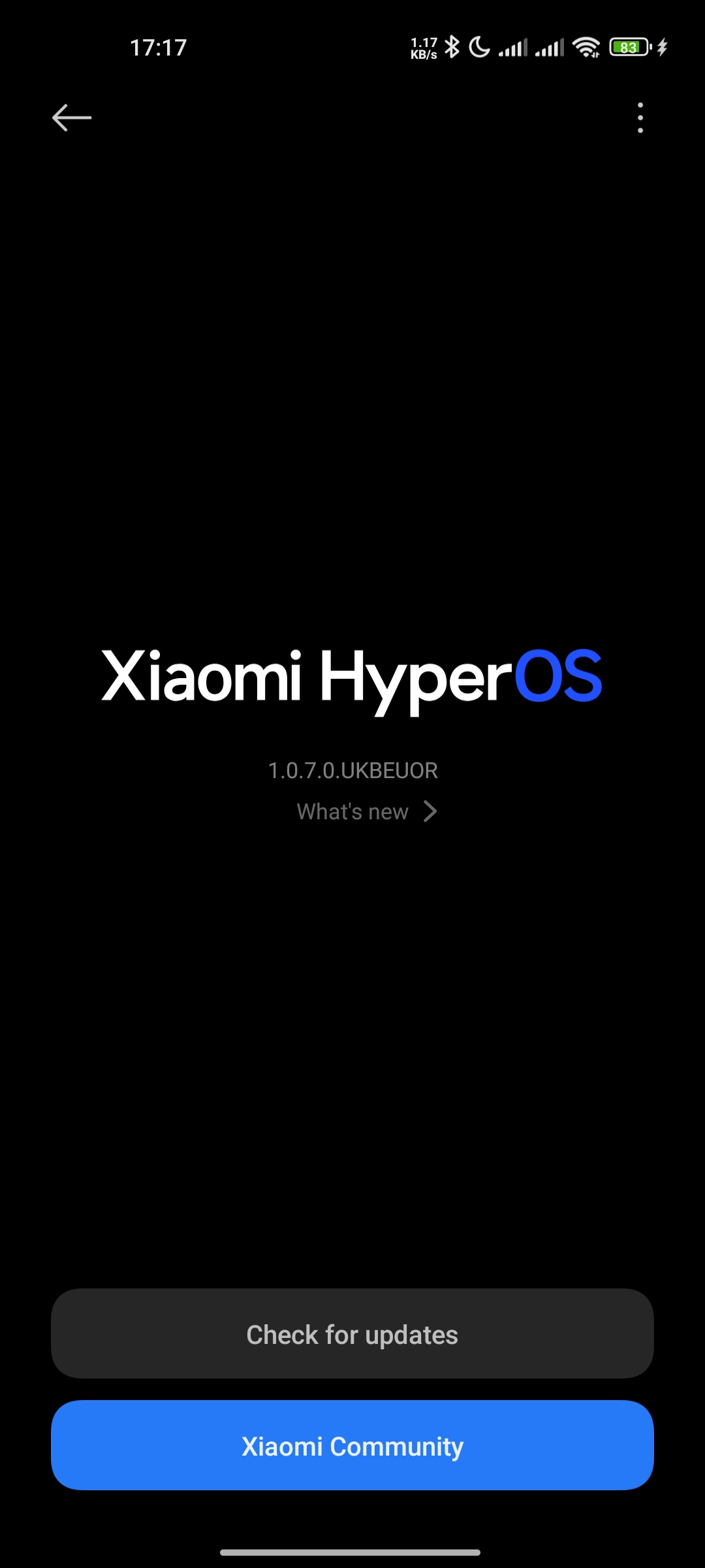

Hi, I just got my Mi 11(Venus) global edition device and I love this phone so much, but I'm not getting builds on system update after HyperOs 1.0.7.0 .. I've tried everything from switching regions to other things. The weird thing is I tried to find my Rom online but it's not available anywhere, it's a HYPEROS 1.0.7.0 UKBEUOR firmware while other ROMS end with XM mine ends with OR. I'm so confused and I don't want to brick my phone by installing the wrong ROM

Your ROM is branded by Orange. That's why you have limited updates.. : https://hyperos.fans/en/devices/venus/
