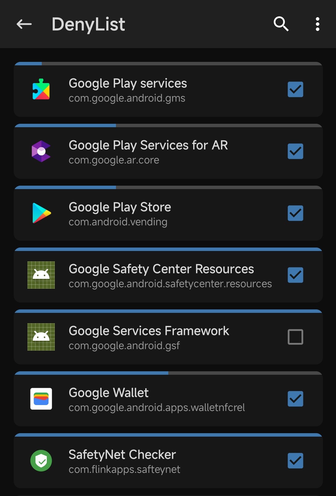

ok for me working for this time later of try lot of methods: for me working like this in poco f3
prerequisites
- magisk https://github.com/topjohnwu/Magisk/releases/download/v26.4/Magisk-v26.4.apk
- xiaomi.eu_multi_HMK40_POCOF3_V14.0.8.0.
- https://sourceforge.net/projects/xiaomi-eu-multilang-miui-roms/files/xiaomi.eu/Xiaomi.eu-app/
- all previous step for install magisk.
for me that working
- uninstall PlayIntegrityFix
- zygisk enable
- enforce denylist enable
- configure denylist with ! important for working google safety center resources !
- clear data of all them
- reboot
- working again google pay
edit:
no working fail again google pay

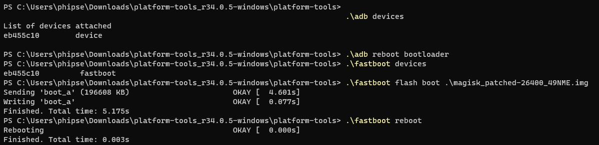

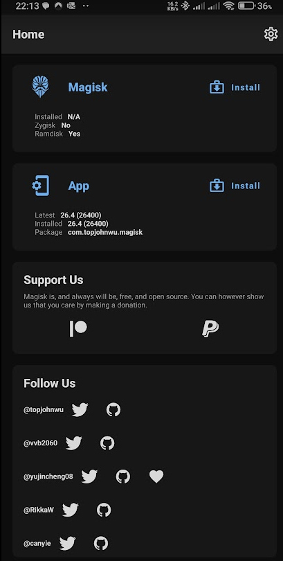

You haven't installed magisk in the first place. You have to download an actual version and flash it via recovery to have it. If you have problems flash orangefox for your device. In orangefox you can flash magisk directly it is included in orangefox. Your device is momentarily not rooted. I love magisk but why they won't offer an actual version to flash via twrp I do not understand. You have to provide a boot.img to root the device with the official magisk version instead it would be more easy to provide a flashable zip that extracts the actual boot.img patches it and flash it afterwards like orangefox do.
I'm facing the same issue. I have patched the boot.img file but when I open Magisk it is just the same. I have a Xiaomi Pro 13 running, V14.0.6.0UMBEUXM Beta. Orange fox doesn't seem to be available for my device.
Flash to both slots (use boot_ab), or flash via twrp

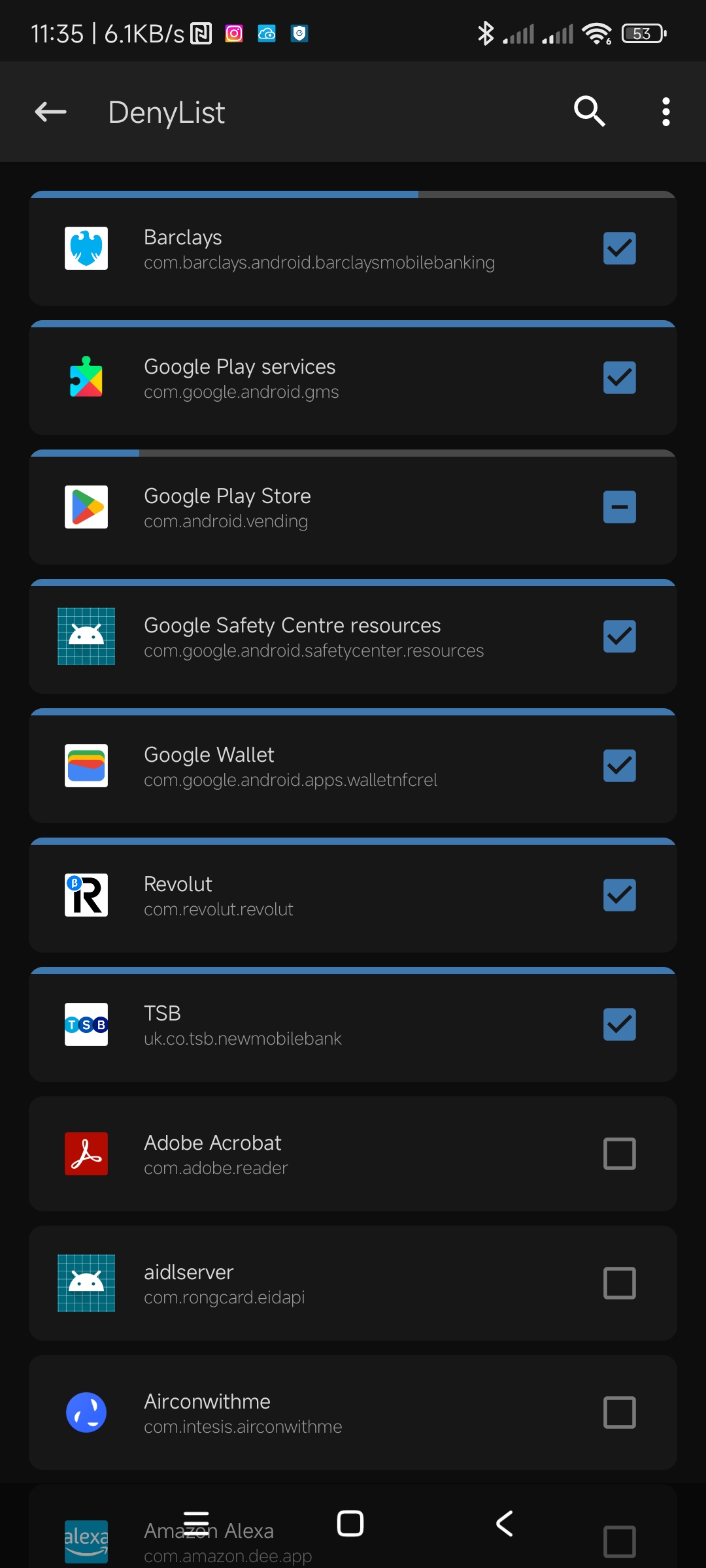

Sorry not MagiskHide, DenyList.
You need to select top right Show system apps
The information was from the developers telegram and it definitely works without it because I have been using pay since two days ago.
And yes, make sure the inject APK is on latest version, mine shows 1st December so I didn't know there was a new version for 5th Dec, I'll probably try update it
