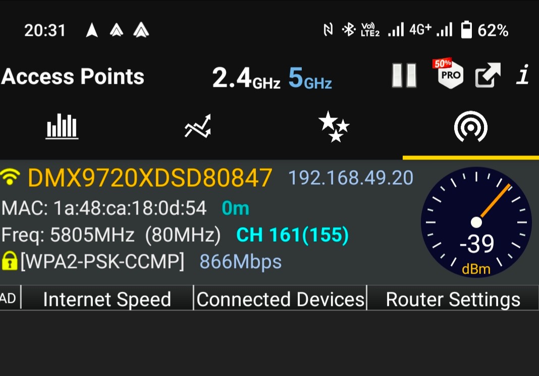

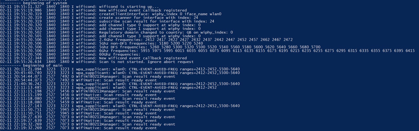

I am sorry, I do not know, how to record it, I tried somewhat from Xiaomi Ultra 11. Plus I send you a channel my car radio uses with another phone (vivo) for AA wireless - see attached. On 12.5.20, there were no problems connecting Xiaomi + this car radio for AA wireless. The problems started with the Miui 13. I am located in CZ.

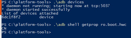

Hmm... can you guys run this command on your Mi 11 / Mi 11 Ultra and let me know what the output is?
Code:
adb shell getprop ro.boot.hwc
Code:
this is the response - attached
That only means that whether CN hardware or GL/GLOBAL hardware doesn't matter, that's good.

I wificond: 60Ghz frequencies:
And this is from Mi 10 (latest Weekly):
Code:
I wificond: Regulatory domain changed to country: GB on wiphy_index: 0
I wificond: 2.4Ghz frequencies: 2412 2417 2422 2427 2432 2437 2442 2447 2452 2457 2462 2467 2472
I wificond: 5Ghz non-DFS frequencies: 5180 5200 5220 5240 5745 5765 5785 5805 5825 5845 5865
I wificond: 5Ghz DFS frequencies: 5260 5280 5300 5320 5500 5520 5540 5560 5580 5600 5620 5640 5660 5680 5700 5720
I wificond: 6Ghz frequencies:
Notice something missing in your logs?
Code:
non-DFS: ... 5745 5765 5785 5805 5825 5845 5865
DFS: ... 5720
Which means:
Code:
CH  | Freq
144 = 5720
149 = 5745
153 = 5765
157 = 5785
161 = 5805
165 = 5825
169 = 5845
173 = 5865
Unfortunately, it's not possible to fix the firmware. Only Xiaomi can do that.
