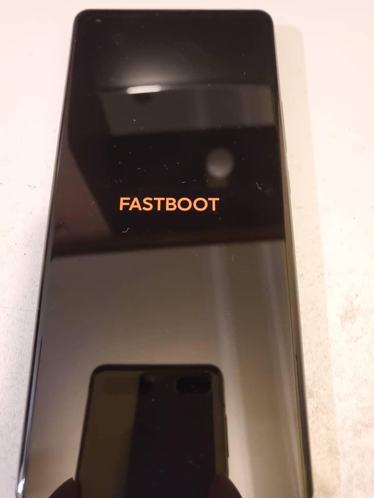

i already read https://xiaomi.eu/community/threads/stuck-in-orange-fastboot-loop.64576/ & tried to wait an hour before redo, but didn't found any solutions.
Basically, i have an unlocked bootloader venus, perfect phone with wifi issue(cannot ON wifi). I the downloaded venus_global_images_V13.0.1.0.SKBMIXM_20220216.0000.00_12.0_global.
Booted into fastboot(the normal blue FASTBOOT word with a bunny tech) & run flash-all directly(from the firmware folder itself). After flashing, my phone is stucked in an orange FASTBOOT word. When plugged in to PC, there's no hardware detection sound from PC, means its totally undetected. tried to press vol down & power, but it started back in the orange fastboot screen. there are times i could get into stock recovery, but there wasn't much i could do from it.
Any help would be much appreciated.

I cant help you right now but I have studied the problem before flashing my Orange Rom on my Mi11. Obviously you have tried to flash the wrong ROM and bricked your phone. It appears that the only ROM that can be easily flashed on a device loaded with the ORANGE ROM is the EEA ROM and not the Global ROM. In any case before flashing you should have done a WIPE and a Format because the formatting of the partitions on the devices are different on orange devices. Altough a computer veteran for many years I didn't delt with fastboot for a long time this is why I am very cautious before undertaking this process. I think you should first try to unbrick your device. from what I read there are some clues in different forums. Once done you should try to flash with the right version of MI flash tools, after a WIPE and Format with the Mi11 TRWP. Before doing anything read of lot of advice on reliable sources of information like xda developers. good luck.

thanks for that instruction! that XIaoMiTool V2 really helped me
