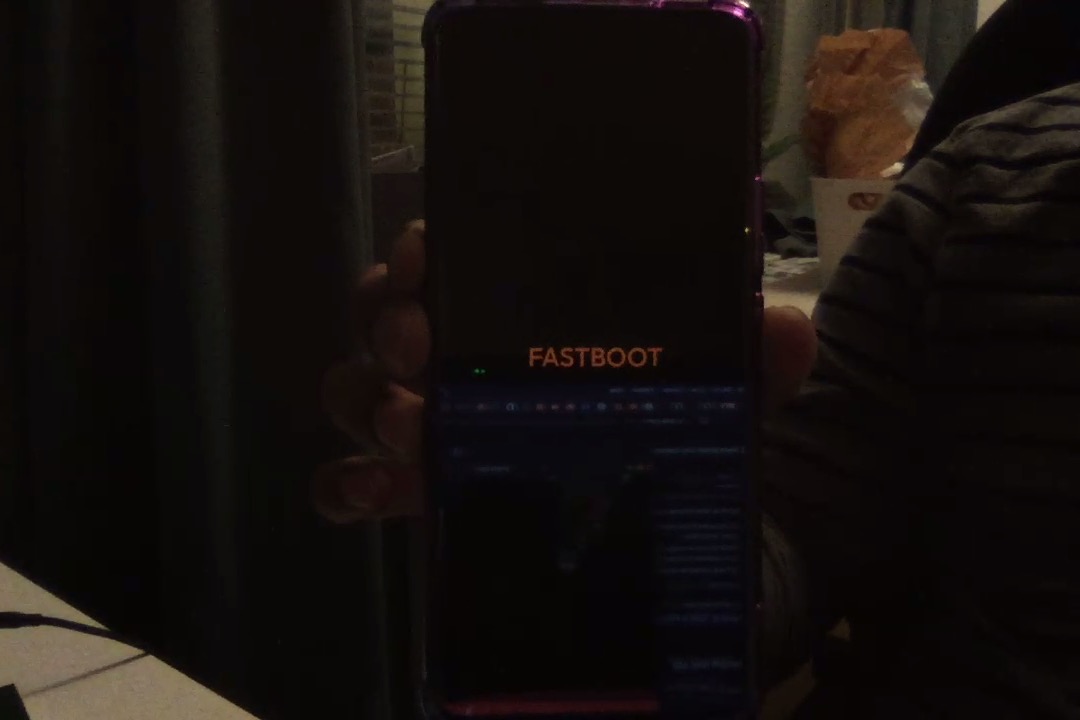

I'm using mi11 (venus), and I tried to install the latest stable ROM (MIUI 13) today.
TL;DR; I got stuck in an orange-fastboot loop and cannot do anything. Can somebody help?
The pic is on the attachment, sorry for the low quality. I used my laptop's webcam for it.
Chronology:
In the beginning, I unlocked the bootloader succesfully.
But then when I tried to flash the ROM, I chose the "fastboot_update_rom.sh" instead of "fastboot_first_install_with_data_format.sh" by mistake.
I got stuck at the recovery mode at first. Tried to restart, but it went straight to recovery mode again.
I managed to flash TWRP, but there is no ROM inside the phone. So I disconnect the cable, try to get the ROM via USB stick (failed to mount), restart the phone, and now I stuck in the orange-fastboot.
I cannot go to recovery mode anymore.
My computer cannot detect the phone anymore.
Everytime I restart the phone, it goes straight to the orange-fastboot mode.
Is there anything I can do to save my phone?

So in my opinion you are in the "wrong" mode. The writing should actually be blue.
If you hold down the quieter key when switching on the phone, you should end up in the correct fastboot mode. The one in blue letters. Then you can run the update script again.

Do you mean power + volume down button?
It doesn't work sadly. I always thrown to the "wrong" fastboot.

Your problems are no phone Brick.
Just not knowing and not wanting to read the miui flashing guide. And it has to be done step by step.
If you do not read it, then there are problems, the most desperate people pay Euro for a remote rom upload.
Read the tutorials two times before you start your adventure with MIUI

You should have just formatted while you had twrp. The bootloop is because of that. When changing ROM branches, you must format due to partition differences between them.
