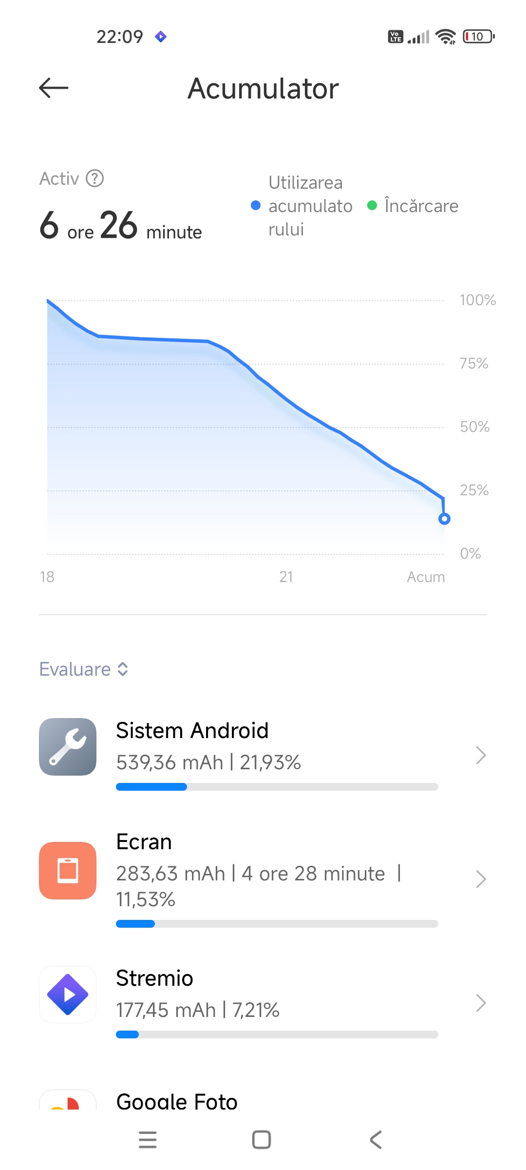

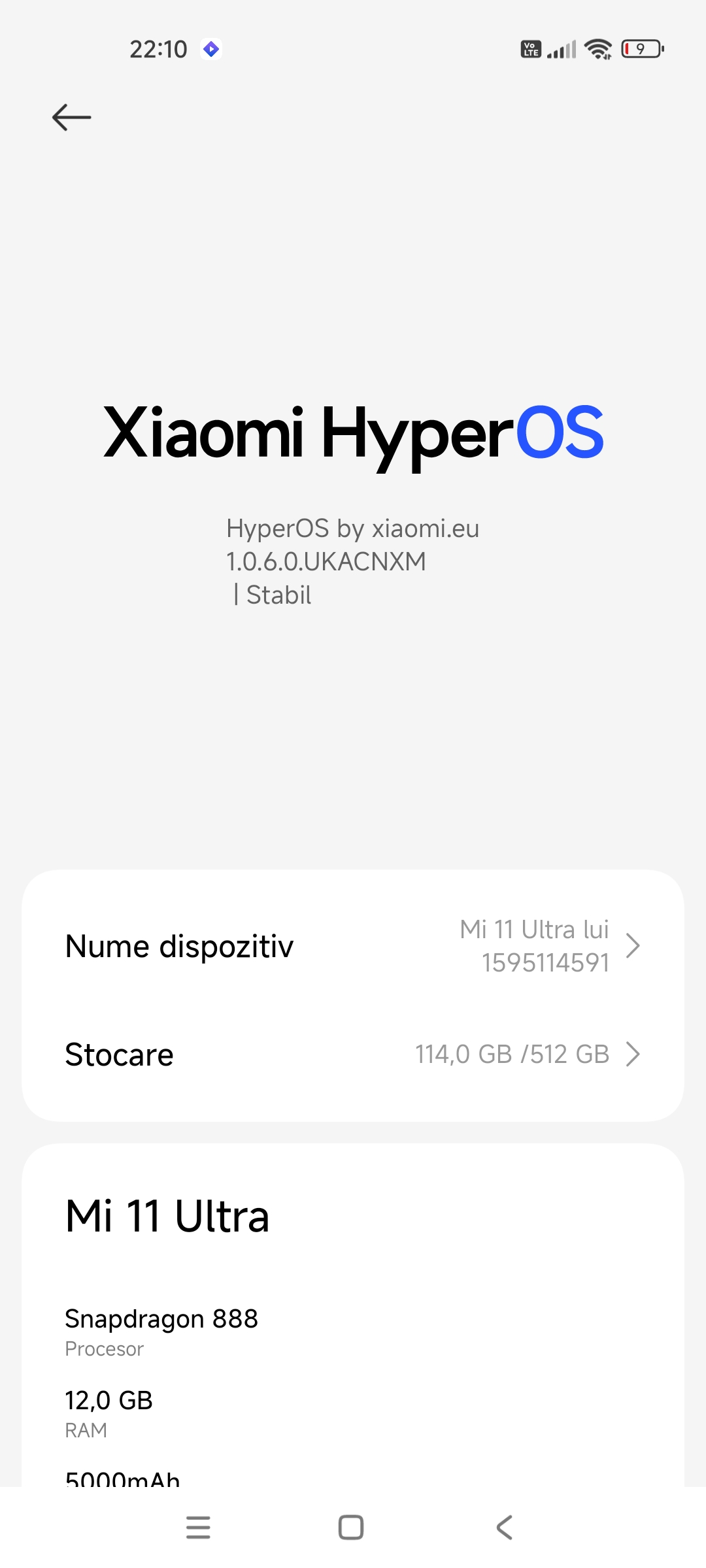

Clean install this is what I got as SOT. Maybe a little laggy sometimes. I still got the problem, under 20% it discharges like crazy. New battery. Same problem even with miui 14. You can see in the pictures.
