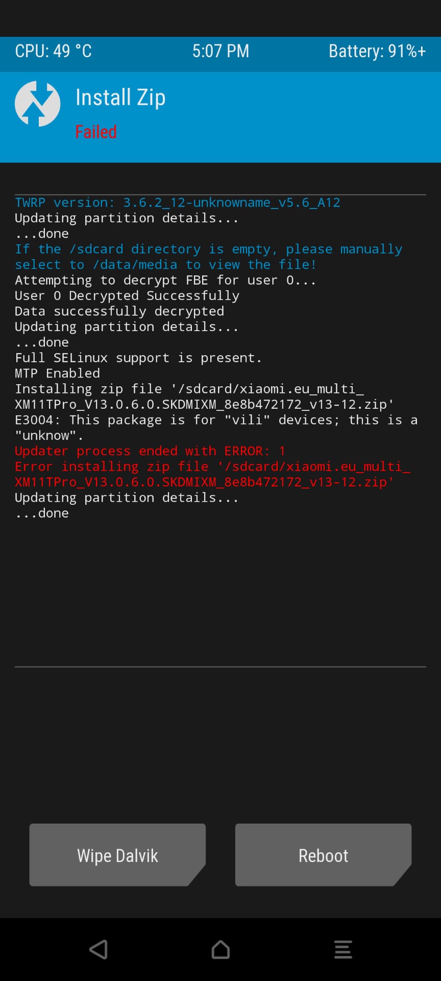

hi everyone,
I managed to install ROM xiaomi.eu_multi_XM11TPro_V13.0.4.0.SKDMIXM_v13-12-fastboot.zip
But, when I put the phone to charge, it charges slower than with the stock ROM, and also it does NOT charge more than 91%.
Also, I can't update to ROM xiaomi.eu_multi_XM11TPro_V13.0.6.0.SKDMIXM_v13-12.zip because it is via recovery, and TWRP has an issue as the screenshot below.
Apparently, my device is "unknow".
Hope someone can help me out.

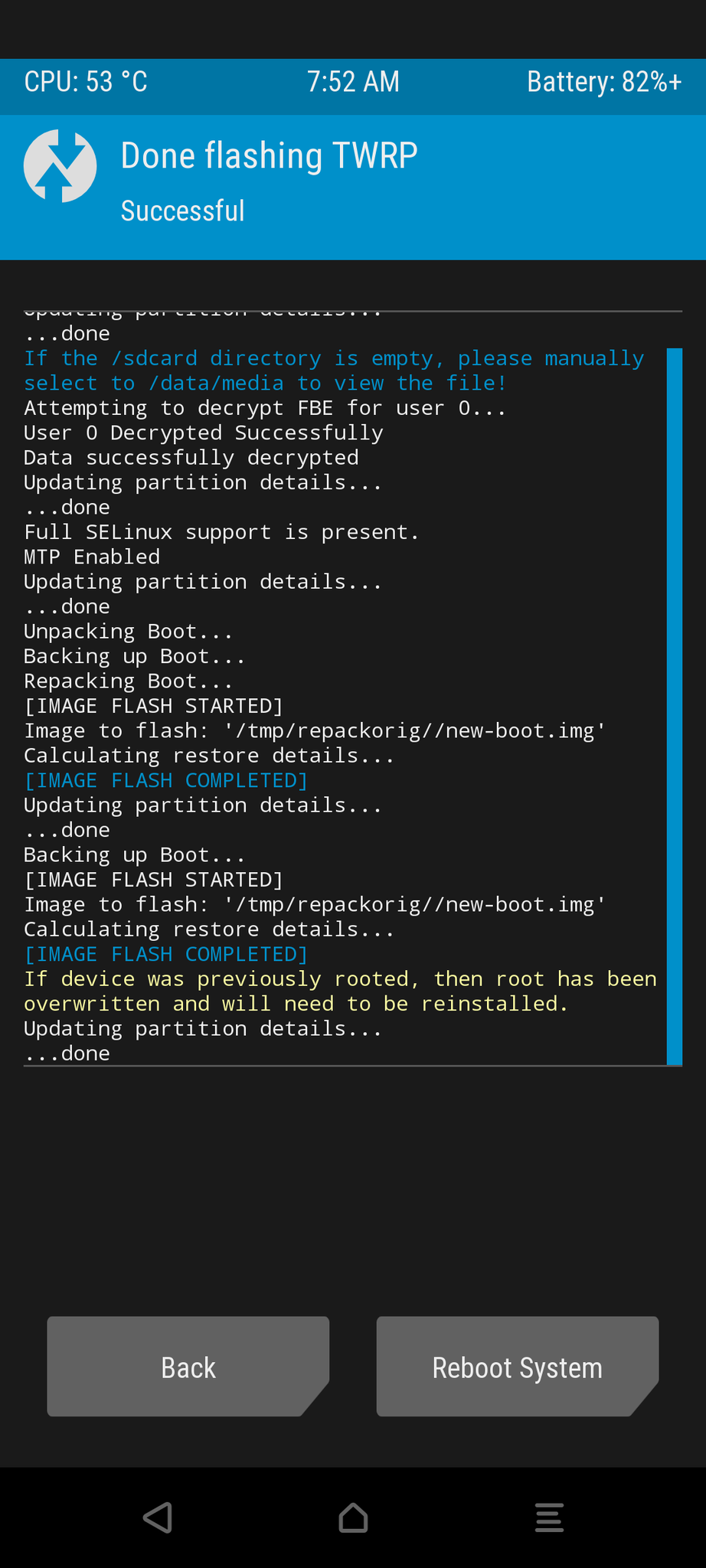

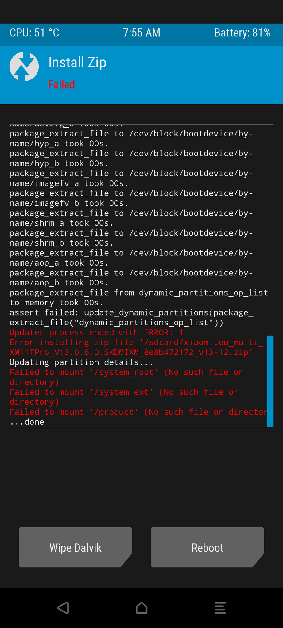

update issue:
Flashed TWRP... Tried to update to 13.0.6.0... Different error.
But thanks to you, I flashed TWRP 3.8.3 which is a won battle for me... Still tried to win the war. :confused:
You must go through the OTA not directly with the TWRP.
