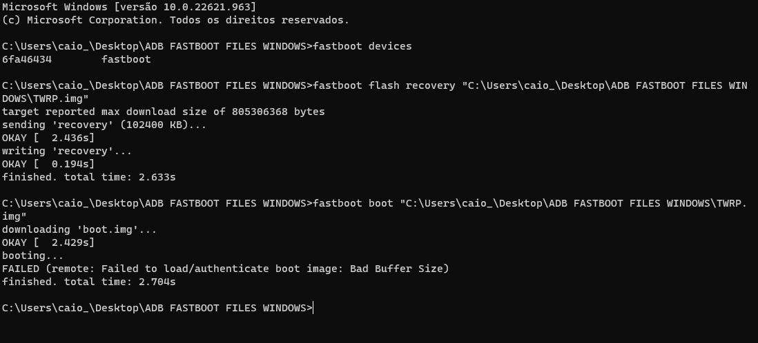

Sorry guys, I'm desperate. I have a 12s PRO and I'm trying to install the European room.
Unlocked the phone and followed all those developer settings.
First, it was giving error.
Second, I tried using a tool called XiaoMiTool V2, but it gave an error and started an infinite boot loop.
I tried to install TWRP in another way, but now it doesn't leave the fastboot screen.
please, help me in a simplified way, I'm a layman, I just don't want to get hurt anymore. THANKFUL.
Esse sou eu tentando instalar o TWRP, mas ele não reinicia no twrp, fica apenas no fastboot e não tem como abrir o celular normalmente.
You can't use that image to boot it.
write:
fastboot reboot recovery
^ that appeared due to old fastboot binary. We had to flash the first .eu version (for fastboot), then flash TWRP and install the newest ROM (flashing China ROM didn't work for some reason...).
Problem solved :)
