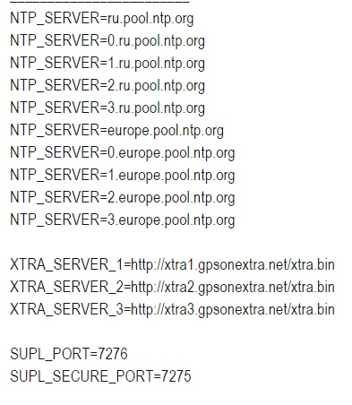

Change gps.conf (look picture).
GPS works!
