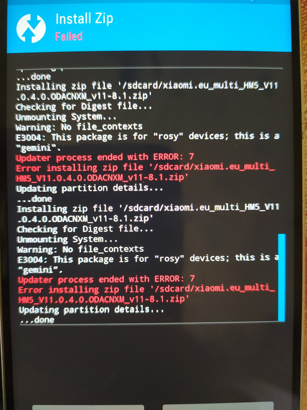

Dear xiaomi.eu I been a fan of your roms for about a year I wanted to install latest ROM on my mi 5 gemini so downloaded this https://androidfilehost.com/?fid=4349826312261693362 and when I try to install it it would say this this package is for rosy...

Aye I'm bit confused how would i know it's for hongmi 5... Would please tell me actual ROM that has to be flashed thanks

Your question shows me, that you've never read the very first post of the download threads weekly/stable: the name of the device is in the name of the zip-file (HM5).
And I don't know the last published ROM of Mi 5, because it is EOL for a while know. Please use search to find it.
HM5 is in the ROM's name... HM = Hongmi = Redmi.
As for Mi 5, the ROM's name has MI5 in it, and this is the last Stable ROM released for it:
