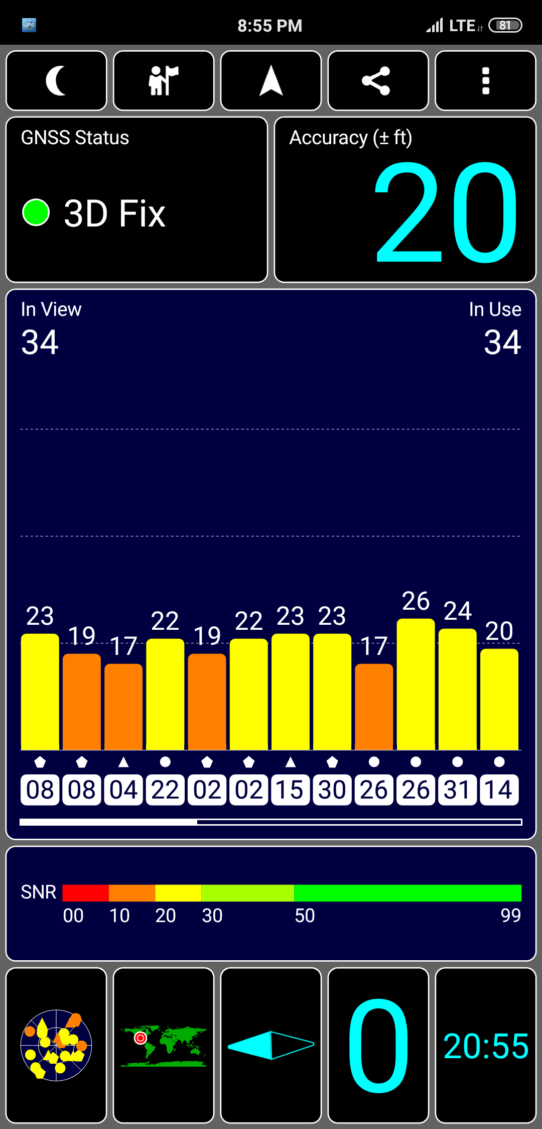

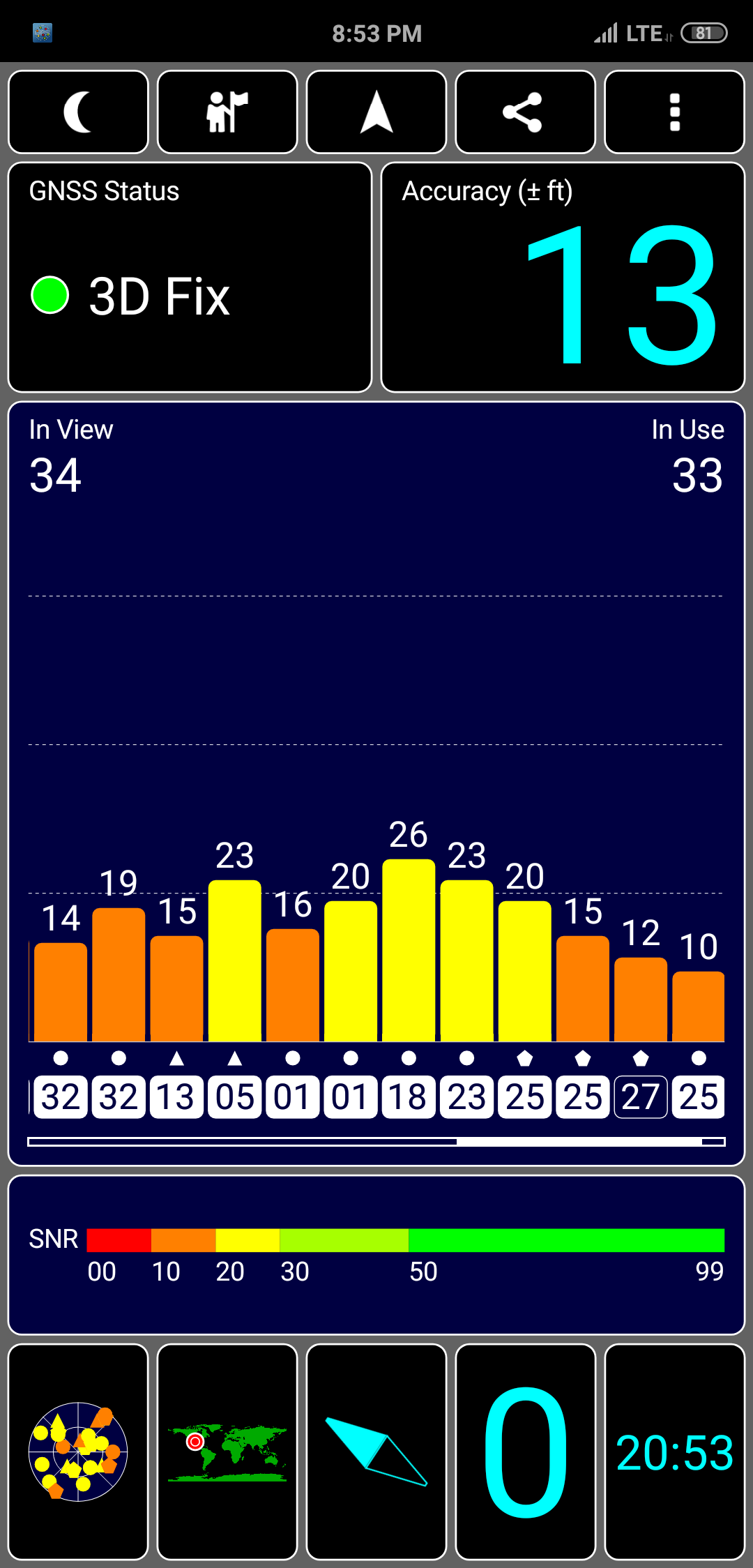

Look at the attached screenshots taken inside my home. Impressive. 33/34 satellites in use with 13 ft/20 ft accuracy.
I had GPS turned off and turned it back on and within 15 seconds, those were the readings. If I walk outside, the locks happen even quicker!
