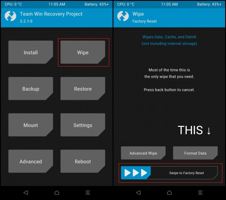

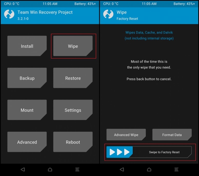

There is a difference between Wipe Data and Format data in TWRP. Go to Wipe section and in the lower right corner there is FORMAT DATA.
Reactions: zmajdk

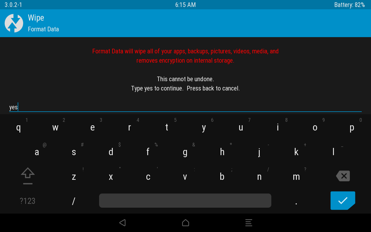

When you click on Format data it asks you to confirm it by typing "yes" like in the screenshot below?
no, on every 3 TWRP that I found I never had to write yes. It goes directly after swap that arrow to format and wiping factory reset
Can you see Format data in the screenshot below? If yes, click on it and confirm by typing yes. Then copy rom to your phone and flash it.
Reactions: DVIALES and zmajdk
