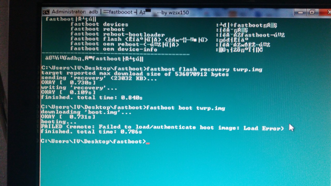

help my xiaomi 8SE not boot

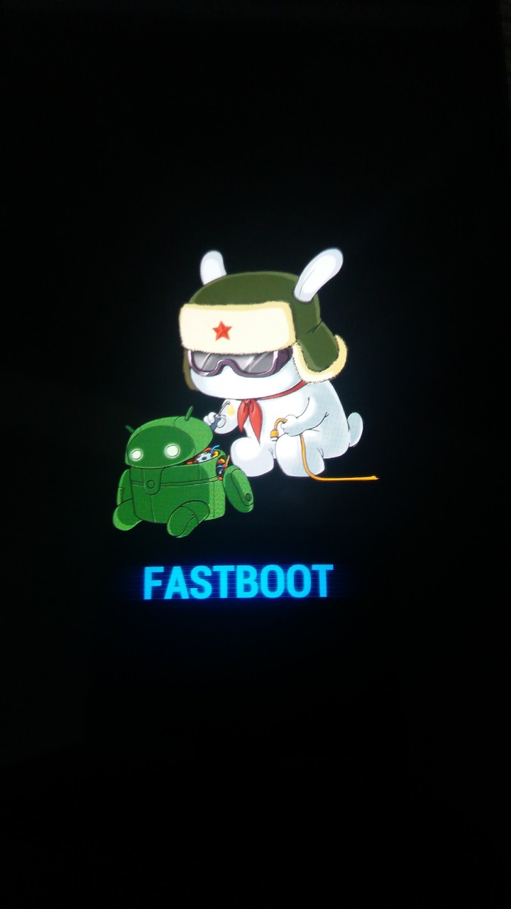

installed TWRP successful but when i try to load to Recovery mode Recovery mode cant load and MI8SE just run on Fastboot mode ! even i choose reboot to recovery mode but only fastboot mode running
tested 2 version - 3.2.1 - 3.2.3
my recovery mode is missing :|
only Fastboot can run on mi8se :|

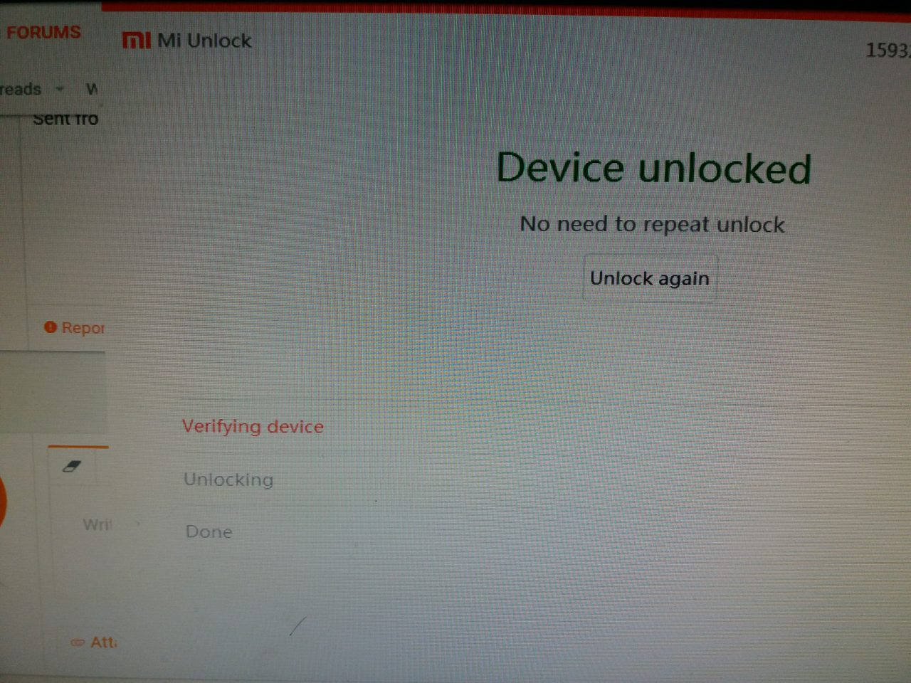

Yes Bootloader unlocked i have only this pictures from display

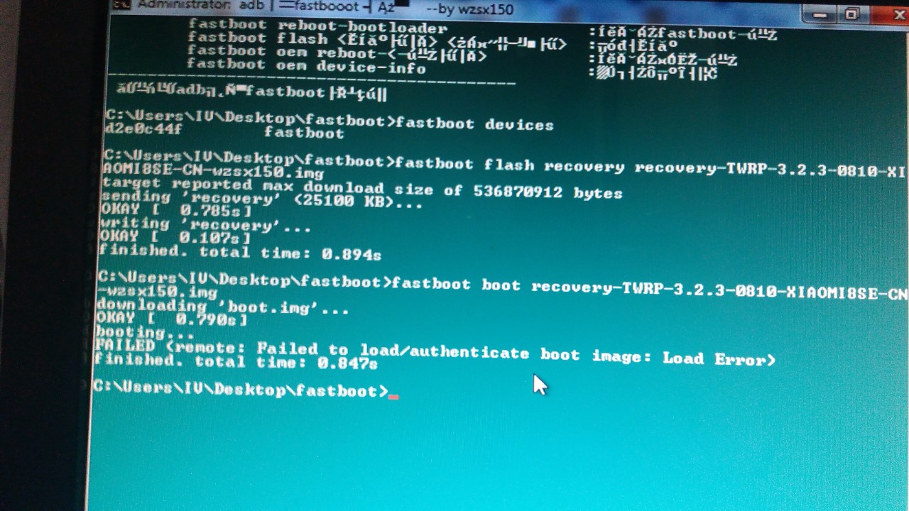

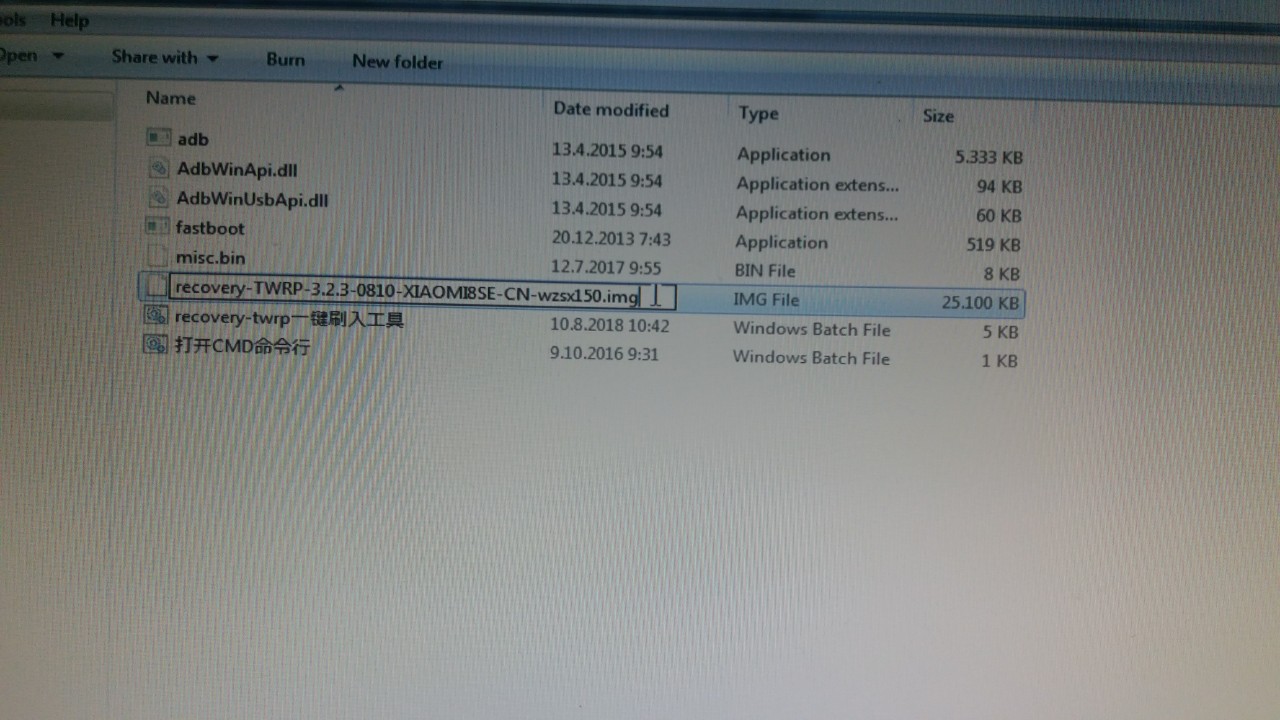

I don't see the command you issued, What is the filename of your twrp?
After you flashed, your command should be Fastboot reboot recovery or just use the button combo.
Can you just rename the file and try again?

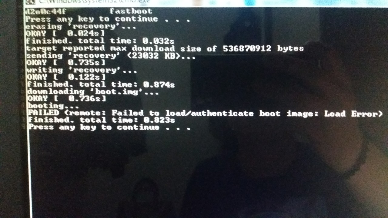

Post also the output:
1. Boot into fastboot attach phone
2. Issue fastboot devices
3. Issue fastboot flash recovery recovery.img
4. Adb reboot recovery
Report back.
I can only imagine it's something wrong with the twrp image.

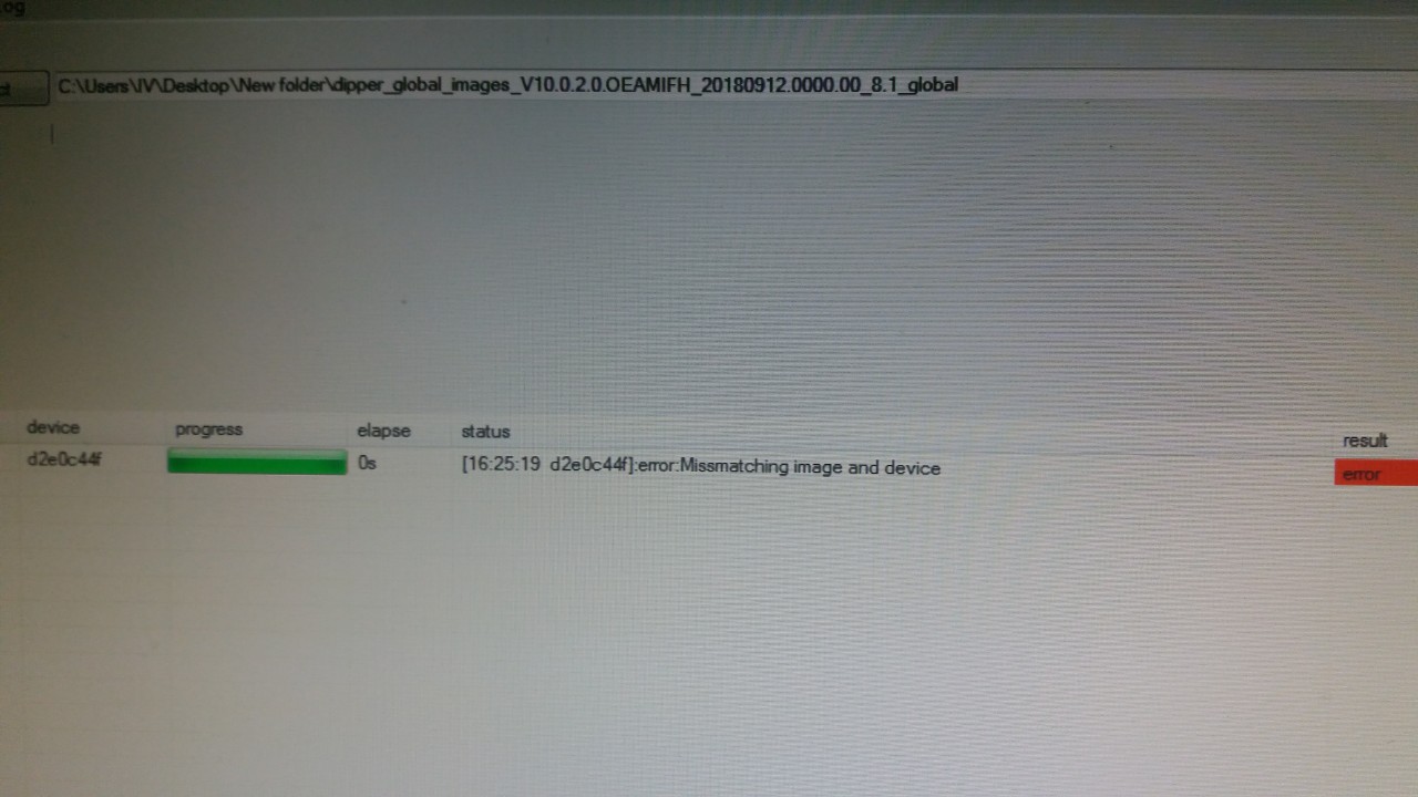

I tried to insert it global rome from this link
https://www.xiaomigeek.com/download-xiaomi-mi-flash-tool.html
this is log
[9:06:16 d2e0c44f]:MiFlash 2017.4.25.0
[9:06:16 d2e0c44f]:image path:C:\Users\IV\Desktop\xiaomi image Global\sirius_images_V9.5.6.0.OEBCNFA_20180605.0000.00_8.1_cn
[9:06:16 d2e0c44f]:env android path:"C:\Xiaomi\XiaoMiFlash\Source\ThirdParty\Google\Android"
[9:06:16 d2e0c44f]:script :C:\Users\IV\Desktop\xiaomi image Global\sirius_images_V9.5.6.0.OEBCNFA_20180605.0000.00_8.1_cn\flash_all_lock.bat
[9:06:16 d2e0c44f]hysical Memory Usage:860160 Byte
[9:06:16 d2e0c44f]:$fastboot -s d2e0c44f getvar product 2>&1 | findstr /r /c:"^product: *sirius" || echo Missmatching image and device
[9:06:16 d2e0c44f]roduct: sirius
[9:06:16 d2e0c44f]:$fastboot -s d2e0c44f getvar product 2>&1 | findstr /r /c:"^product: *sirius" || exit /B 1
[9:06:16 d2e0c44f]:$fastboot -s d2e0c44f erase boot ||
[9:06:16 d2e0c44f]:erasing 'boot'...
[9:06:16 d2e0c44f]:OKAY [ 0.010s]
[9:06:16 d2e0c44f]:finished. total time: 0.010s
[9:06:16 d2e0c44f]:$fastboot -s d2e0c44f flash crclist C:\Users\IV\Desktop\xiaomi image Global\sirius_images_V9.5.6.0.OEBCNFA_20180605.0000.00_8.1_cn\images\crclist.txt ||
[9:06:16 d2e0c44f]:error:error: cannot load 'C:\Users\IV\Desktop\xiaomi': No such file or directory
[9:06:16 d2e0c44f]:flashSuccess False
[9:06:16 d2e0c44f]:isFactory False CheckCPUID False
[9:06:16 d2e0c44f]:before:flashSuccess is False set IsUpdate:True set IsDone True
[9:06:16 d2e0c44f]:after:flashSuccess is False set IsUpdate:false set IsDone true
[9:06:17 d2e0c44f]:"Flash crclist error"
[9:06:17 d2e0c44f]:error:error: cannot load 'C:\Users\IV\Desktop\xiaomi': No such file or directory
[9:06:17 d2e0c44f]process exit.
