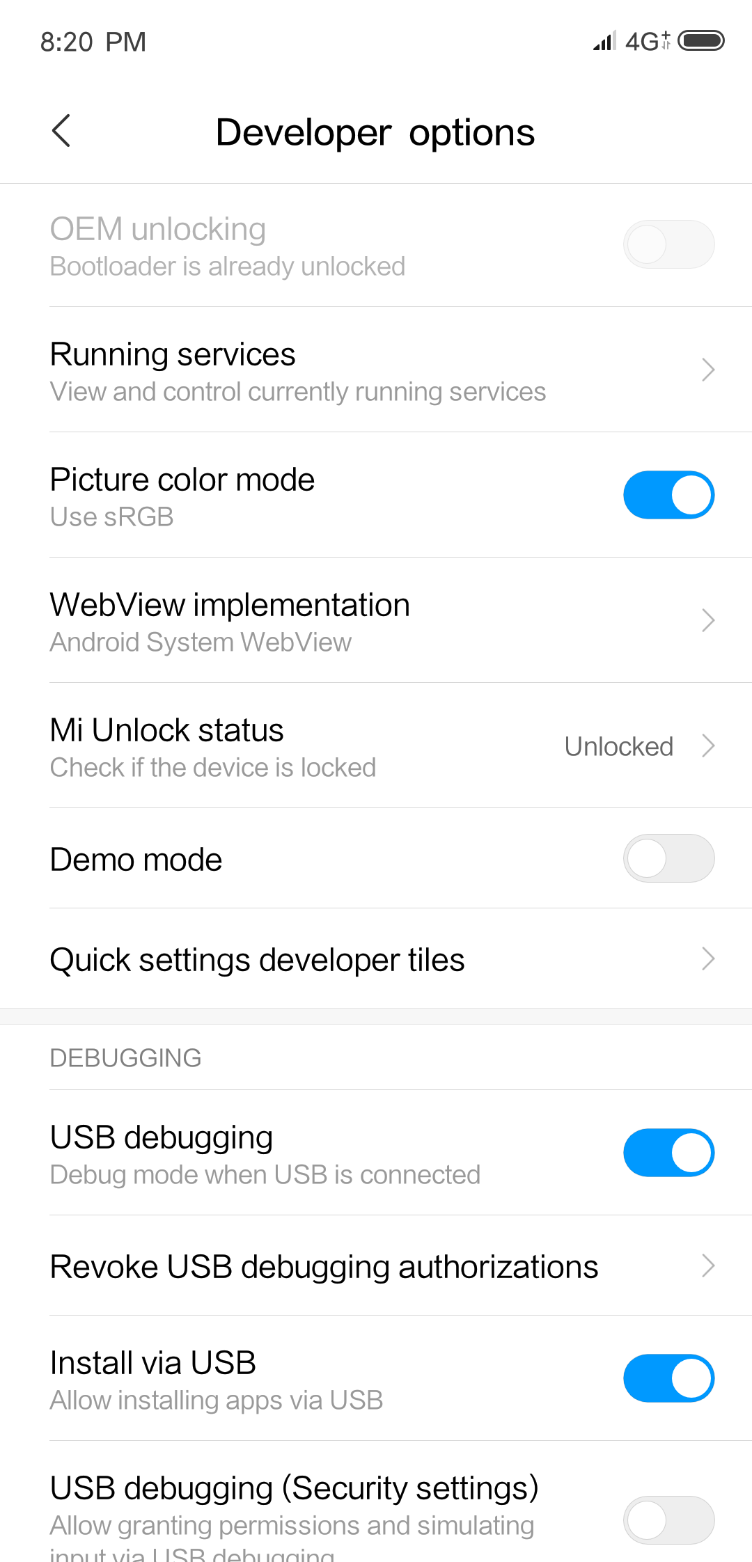

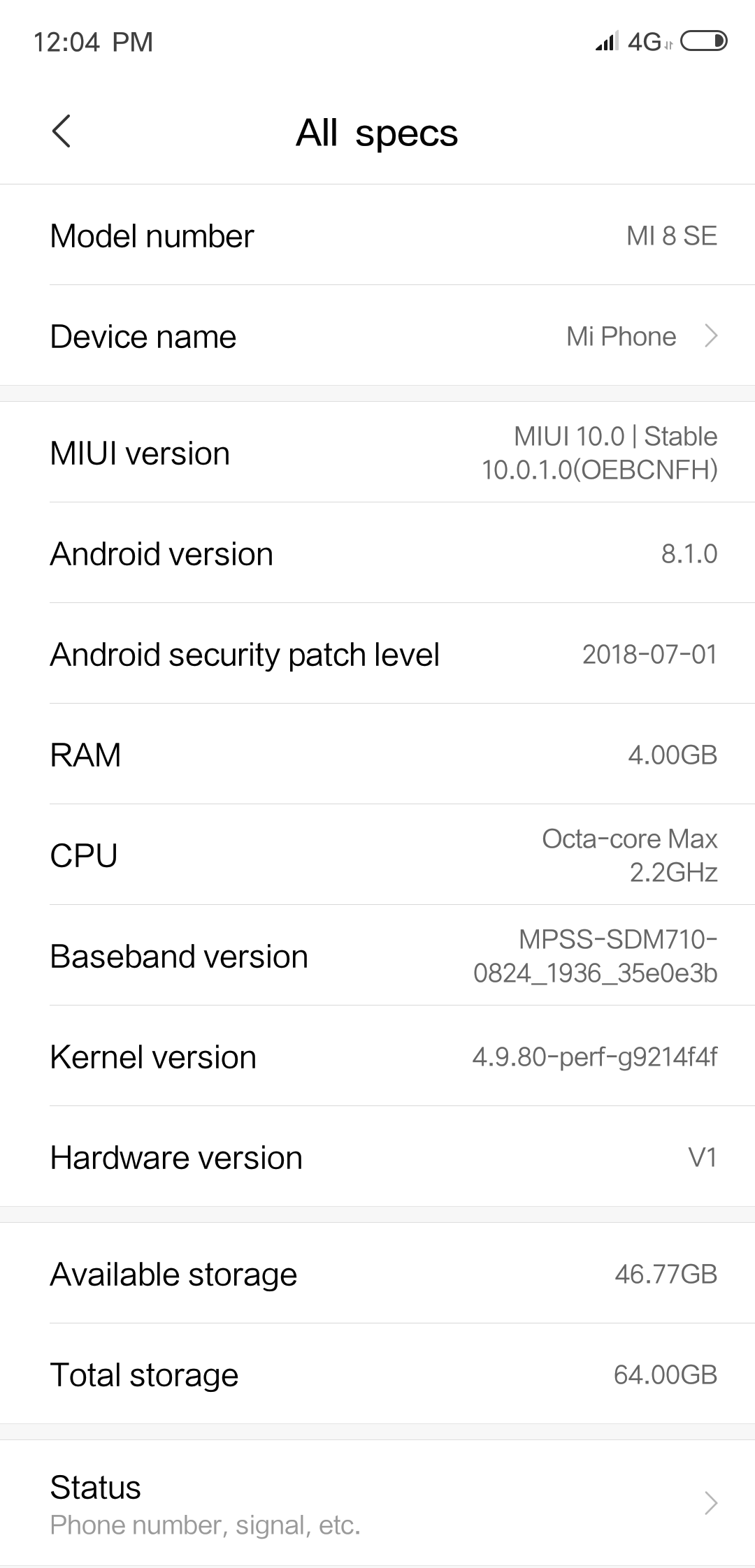

Hallo, I am a newby here and from reeding a couple of threads I found out that quite a bit can go wrong easily. I just got my MI 8SE and have no experience in flashing roms and never worked with adb fastboot etc... I do not want to brick my phone, so what would you recommend me not to do or try? If possible I would also like to avoid a bootloop ;-) I will post my configuration next, please tell me if you need further Information.
Many thanks in advance!
Please find my current configuration attached. Currently there is MI recovery 3.0 installed on the recovery Partition in Chinese, so I cannot read anything ;-)
