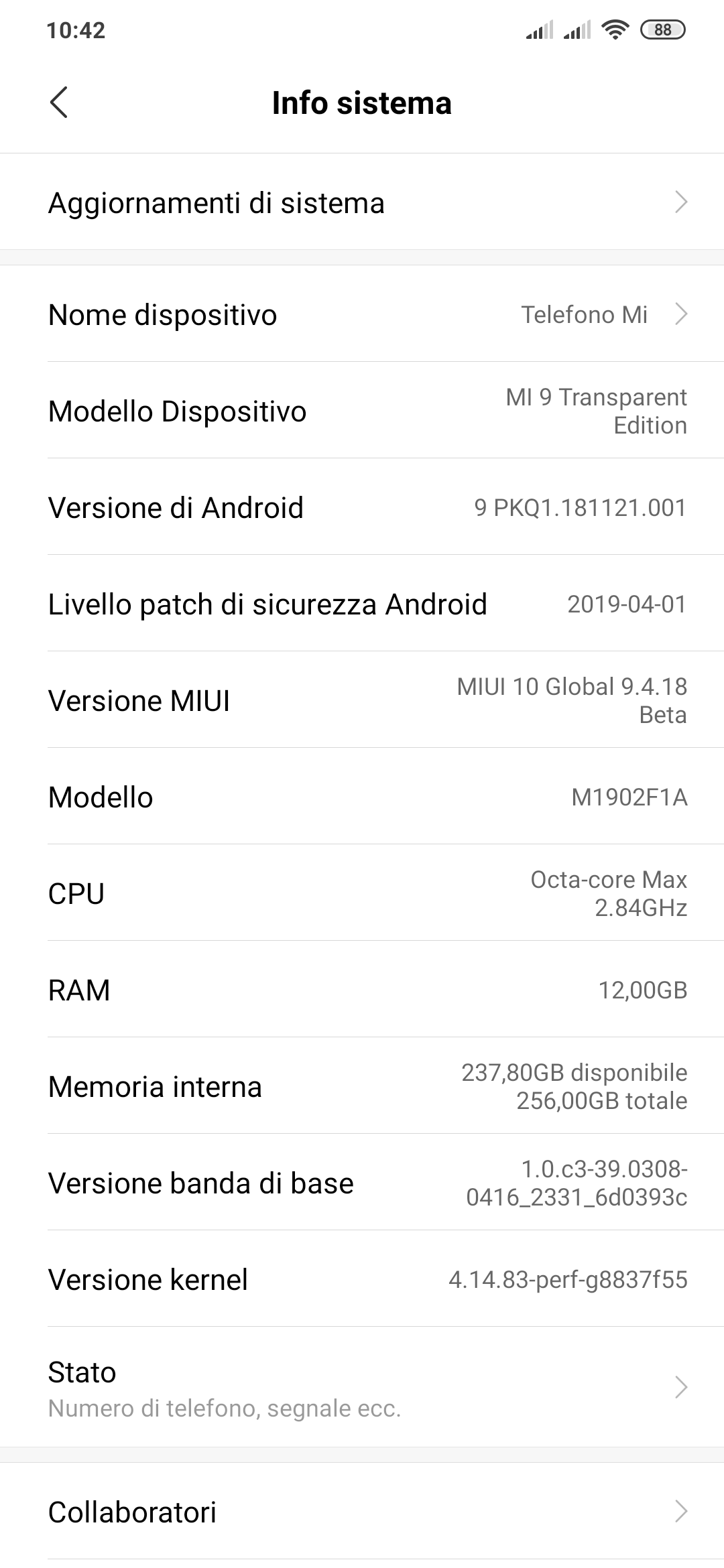

I flashed xiaomi.eu rom on my MI 9 12/256 CN/EN, it works well, same as other MI 9. Go ahead, no risk !
