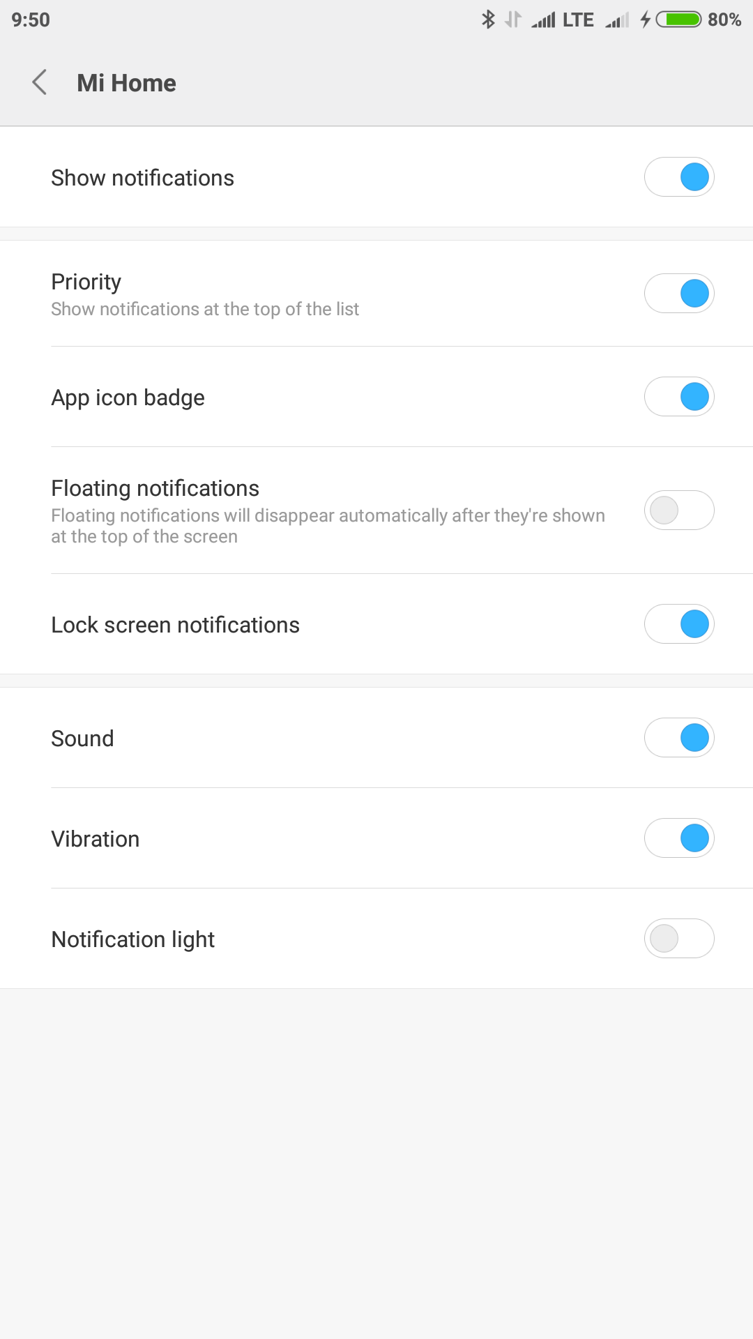

Notifications coming through whilst app open, but non if lock screen is on even though MiHome is set to priority. Any ideas?
settings -> installed apps -> mi home -> custom notification -> (enable lock screen notifications and priority options)
