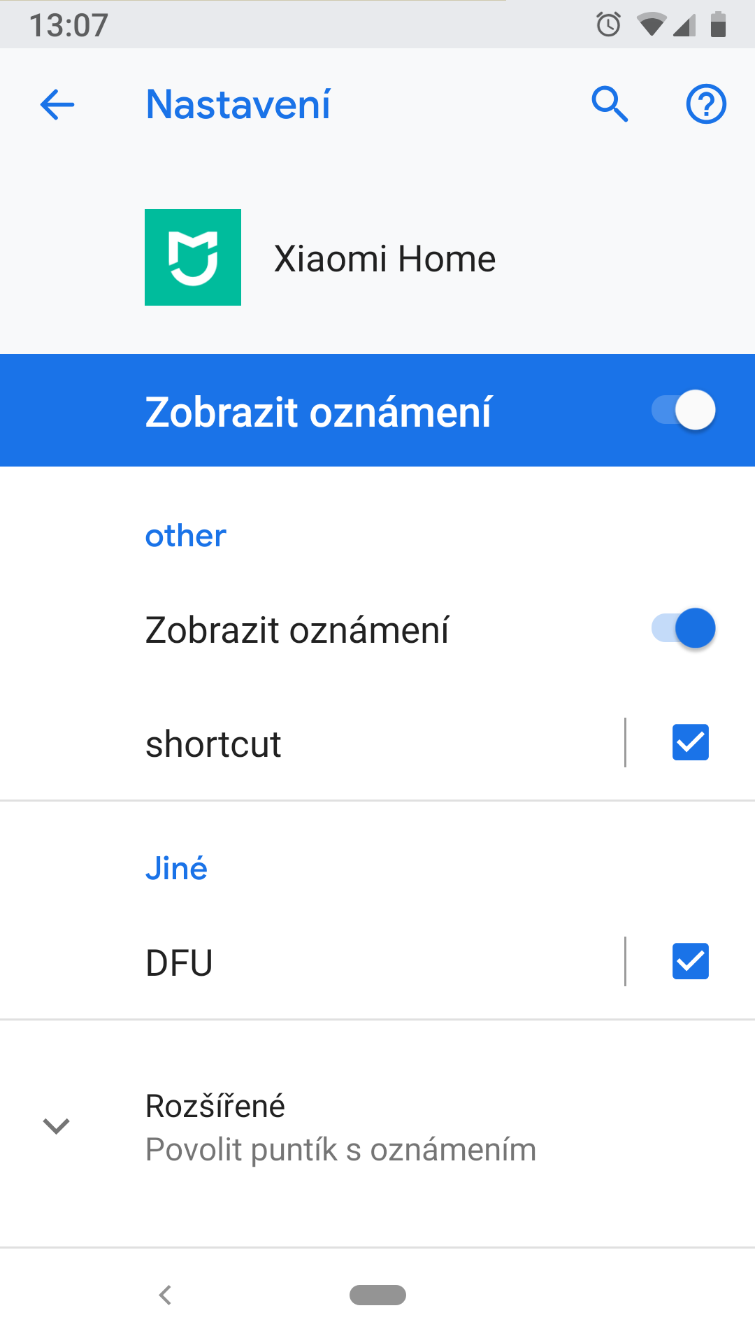

I have a problem with notifications last few days. They don't work. I've checked notifications setup for Mi Home app and now there is only notification for DFU (device firmware upgrade). Attached img. When notification worked there was another notifications "XIAOMI HOME", but now they disapeared and I don't know why.
I share devices with my wife and she still have XIAOMI HOME notifications in setup.
I tried to instal older version and also beta version, with no success.
Any idea?
Any idea?
Phone: Pixel 2

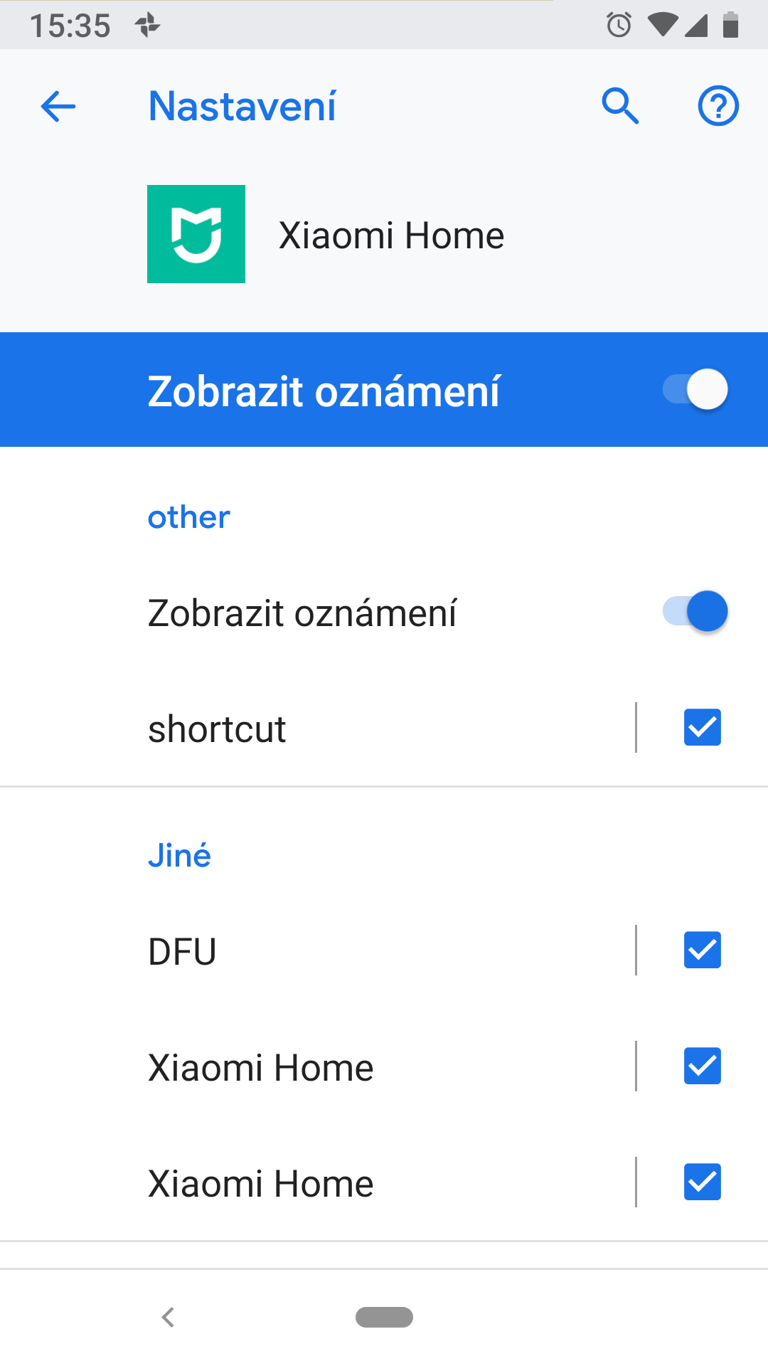

. Suddenly the option "XIAOMI HOME" notification is there and everything work. I did nothing.
Don't understand.
