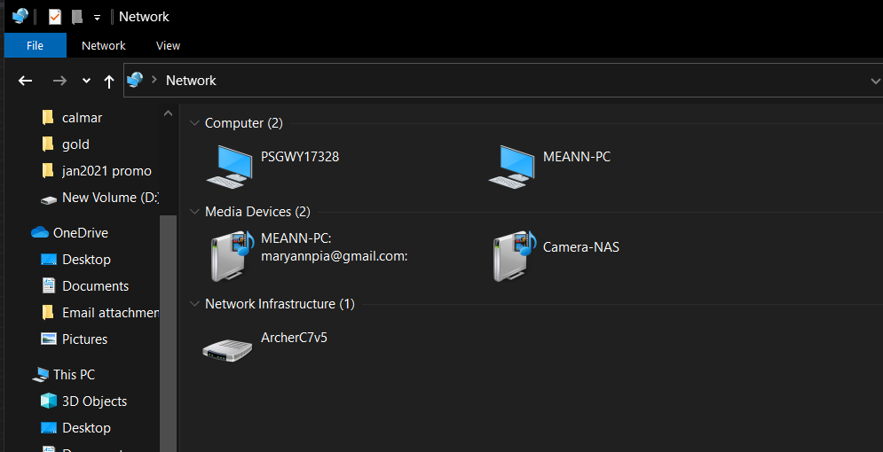

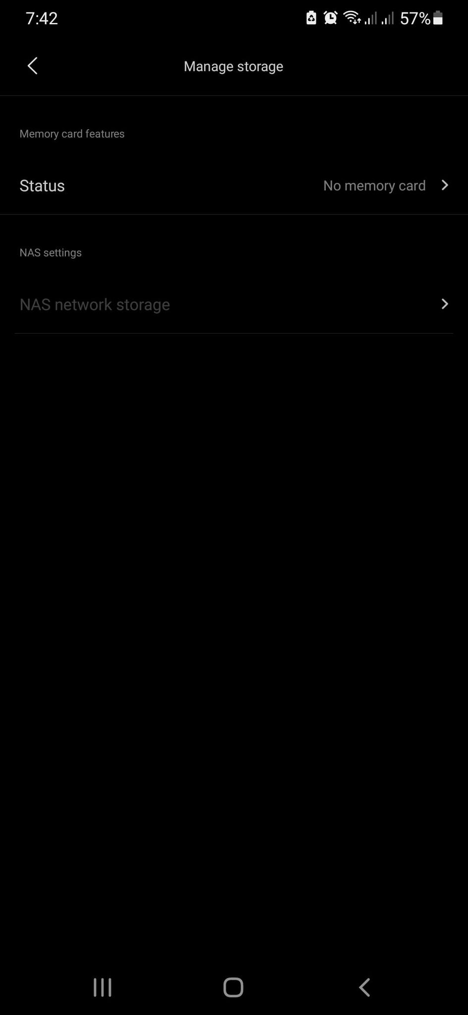

i have similar problem im using tplink archer c7 v5.0. i already see the HDD on my network but im unable to
they said you must insert a memory sd card 1st before it became available but i haven't it try

I can confirm that the Mi 360º Camera (1080p) only supports SMB v1.
Any higher, and the Camera will not detect your NAS / Server.
Thus, you should check your NAS / Server settings, and see if you can downgrade your SMB version support.
On QNAP NASes is under "Advanced Settings", and "Lower [supported] version".
