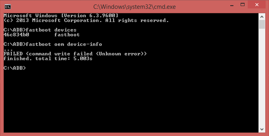

1. Why the command fastboot oem device-info didn't work? This command gives info whether mobile is locked or unlocked.

1. On the command line question - don't remember by heart, but try fastboot into twrp.img - if your bootloader is locked you can rest assured you will understand it by two.img failing to load via fastboot :)
3. Proceed on presumption that your bootloader is not locked. If you fail to load twrp.img than your bootloader is locked and so you will need to switch a longer route and unlock it first.

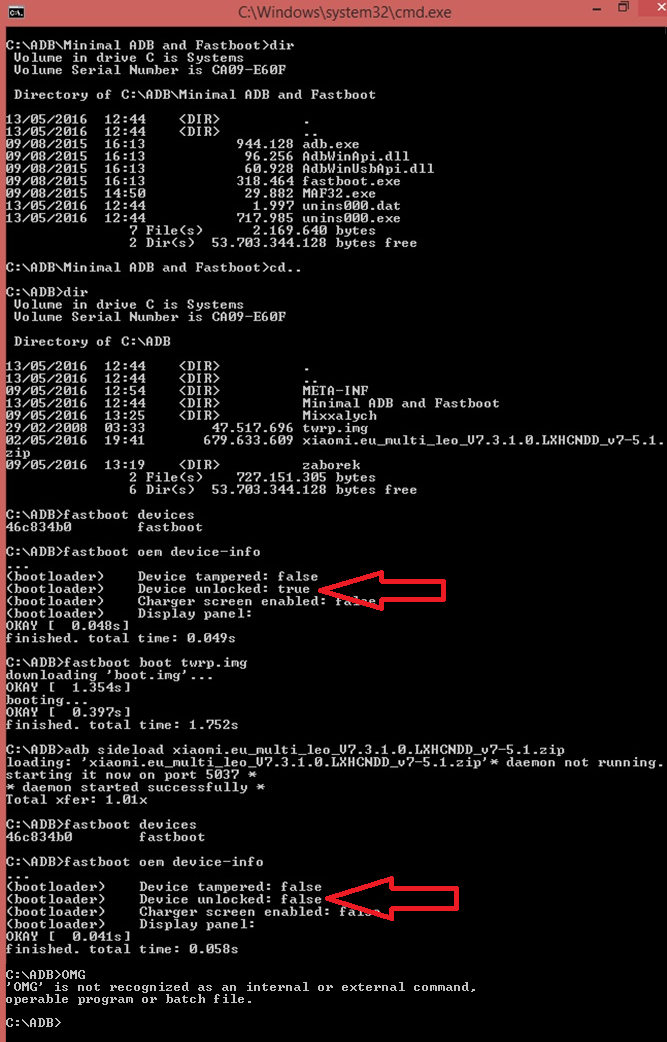

Thanks a lot for this very useful guide ... @Mixxalych , I did it without going the long route ... :)
1. I apply the unlock permission through this http://en.miui.com/unlock/ and got it within 7 days or so ... but it is very fast ... my reason to unlock my mi note pro is just to install the EU unofficial international ROM ... :D:D:D
2. I got message from Xiaomi that I have the permission to unlock my device and I download the unlock tool http://en.miui.com/unlock/ . You can download the tool after you got the unlock permission...:)
3. I did exactly as per the Q15 but after issuing the FASTBOOT DEVICES, I want to know whether my device is locked or unlocked by typing the command FASTBOOT OEM DEVICE-INFO ... and it is TRUE for the unlocked status and so I follow the rest of the steps. SUCCESSFUL ... :)
4. After rebooting, my device looks just like I got a new phone ... and no more Chinese apps ... hahaha and .... blabla ... but to my surprise Xiaomi locks my Mi not Pro once again .... :confused::confused::confused: ... OMG, Xiaomi controls my device ... :D:D:D @xiaomi , you know I am a good guy ... :D:D:D
Anyway, thanks again to @Mixxalych , you have done a great job ... :)

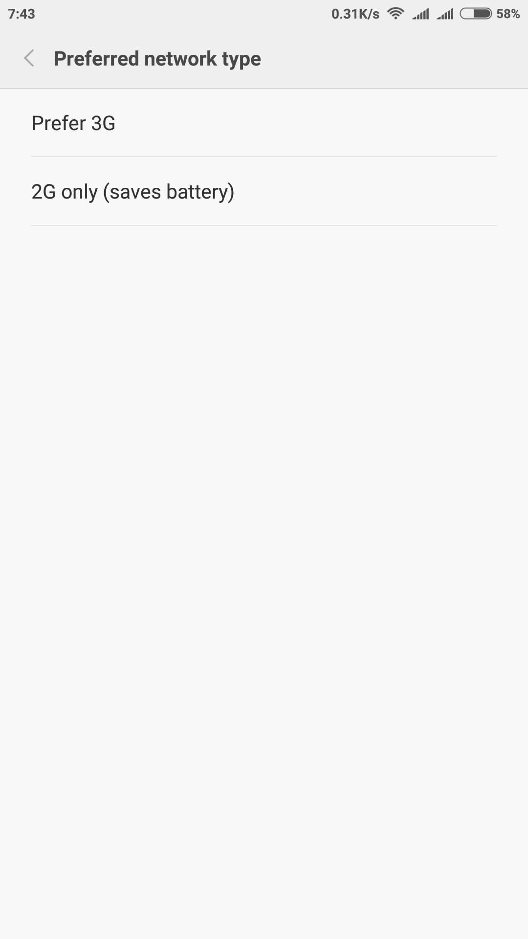

Please Help how to enable LTE option after flash Mi Note (Virgo) with xiaomi eu Rom..

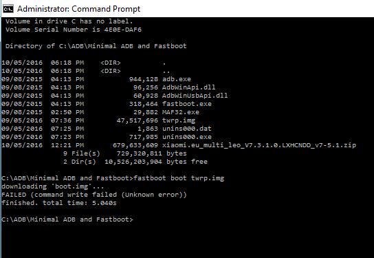

I'd suggest you start with Q15 and see how it goes . It is very unlikely that you will not be able to switch into "Fastboot mode". Then, if you are able to boot into TWRP as suggested in Q15, continue following the Q15. If you fail to boot into TWRP you need to go the long route as suggested by Q17.
If in any doubt - please post a screenshot here and a description of what you were doing.
Not necessary to enable LTE on my Virgo. LTE is there automatically.
I do not understand...It (Virgo) is available in two versions: double netcom (标准版) and full netcom (全网通)...
Maybe this is the difference...
Before EU ROM, did you have LTE?
