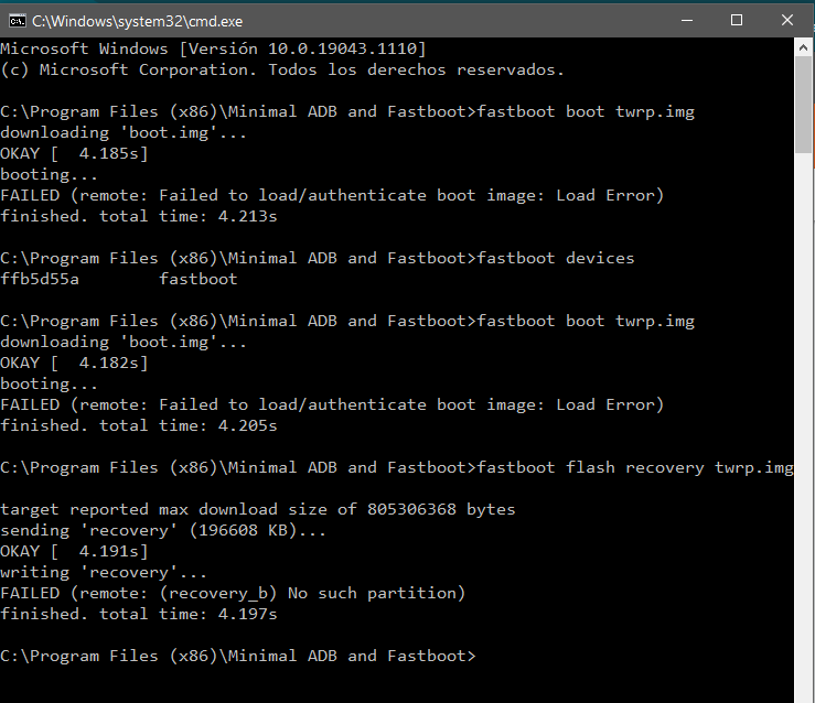

Buenos días. Hace 1 mes, compré el Mi11 pro en China. Ayer desbloqueé el gestor de arranque. Al intentar instalar Xiaom.eu tuve un problema con Twrp. Ahora el móvil está continuamente en modo fastboot y no se desactiva con power + vol- y el Twrp no se activa con power + vol +. Siempre está encendido y no se apaga. Intenté flashearlo con mi herramienta flash, pero la rom que descargué no debería ser la versión china y me da un error anti-rollback. No sé qué puedo hacer para solucionar el problema. Le agradecería mucho que me diera una solución práctica. Gracias.
Al intentar instalar twrp.img me da el error que he adjuntado.

There are many people who speak different language different languages here and the moderators decided as English would be the common language to be used. I don't read or speak Spanish. Can you access fastboot? It sounds like a format of the data partition issue. If you need to format your storage, either download TWRP and place your device in fastboot and run the ADB command from your PC <fastboot boot TWRP.img> from there format your data or choose an older fastboot rom for your device. Follow the installation instructions. The script on the <first_time_install.bat> file will format your internal storage. At that point, you can either choose the upgrade feature to upgrade to the latest Xiaomi.eu rom or exit the rom, reboot to MiFlash and flash your favorite stock rom.
Hello. Yes. I can access to fastboot mode normally con power + vol -. I write in English but it translates automatically into Spanish. I don´t know what i can do to solve this.
But the device is locked and I cannot access developer options because it is stuck at the password login screen. How do I unblock it? As I said in another post, I managed to flash the Chinese rom but I did it with the clean all and lock option. Then the mobile was working but I updated it to a later version of Chinese rom and after that I cannot access the mobile menus. How could I roll back the update to the previous version?
Is your Bootloader still unlocked? If it was accidentally locked, run the MiUnlock tool again. If it isn't use one of the fastboot roms from Xiaomi.eu. This will format you entire internal storage/data partition. Then go ahead and either install TWRP and upgrade to the latest version of Xiaomi.eu or use MiFlash to install the China, EEA or Global rom. Here's a link to a software database: https://mifirm.net/downloadeu/7536
Install of fastboot rom guide: https://xiaomi.eu/community/threads...iaomi-eu-rom-for-xiaomi-mi11-pro-ultra.59486/
At the very beginning you made a mistake with the fastboot flash command. You should use the command fastboot boot recovery in order to start recovery.

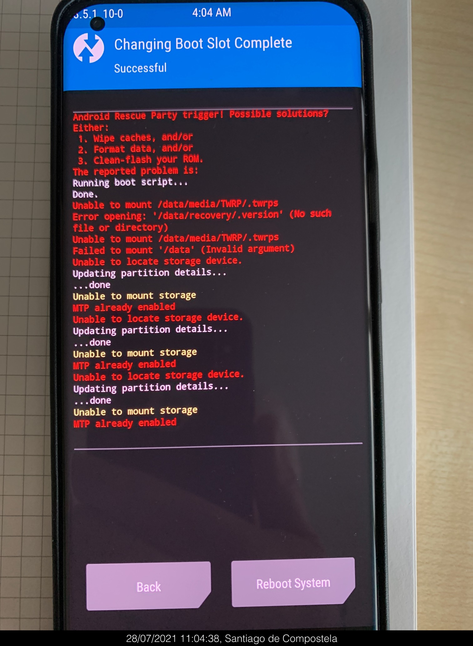

Hello.When installing the rom xiaomi.eu (weekly version) from twrp this screen appears. What do I do? Thanks.

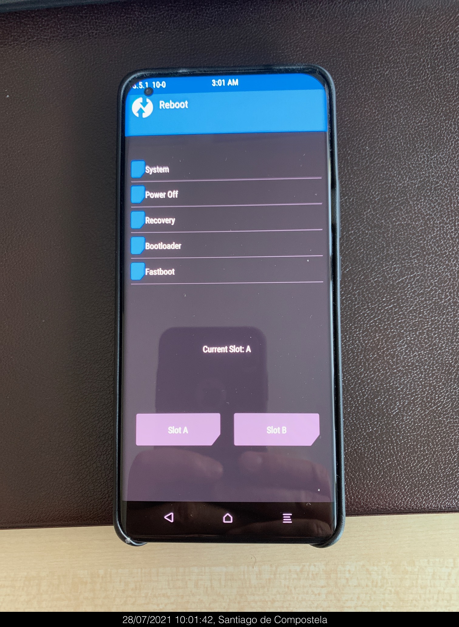

[QUOTE = "Poney70, publicación: 620702, miembro: 248356"]
Hola, seleccione "Sistema" y seleccione la ranura actual (por lo tanto, "Ranura A") si es necesario. ;)
[/CITA]
I have done. Before clicking on System, I have chosen slot A and the attached screen was shown. Then when clicking on System the device was restarted and has returned directly to Recovery.
I guess you have to format the data partition. ;)
Once you have installed the rom and you are on the reboot scree, just select <SYSTEM> and allow the phone to reboot to the system. If this is the first time after install of rom, this can take upwards of 10 minutes. Please be patient and let it boot! At this point, you have already flashed your rom, so just reboot into system.
