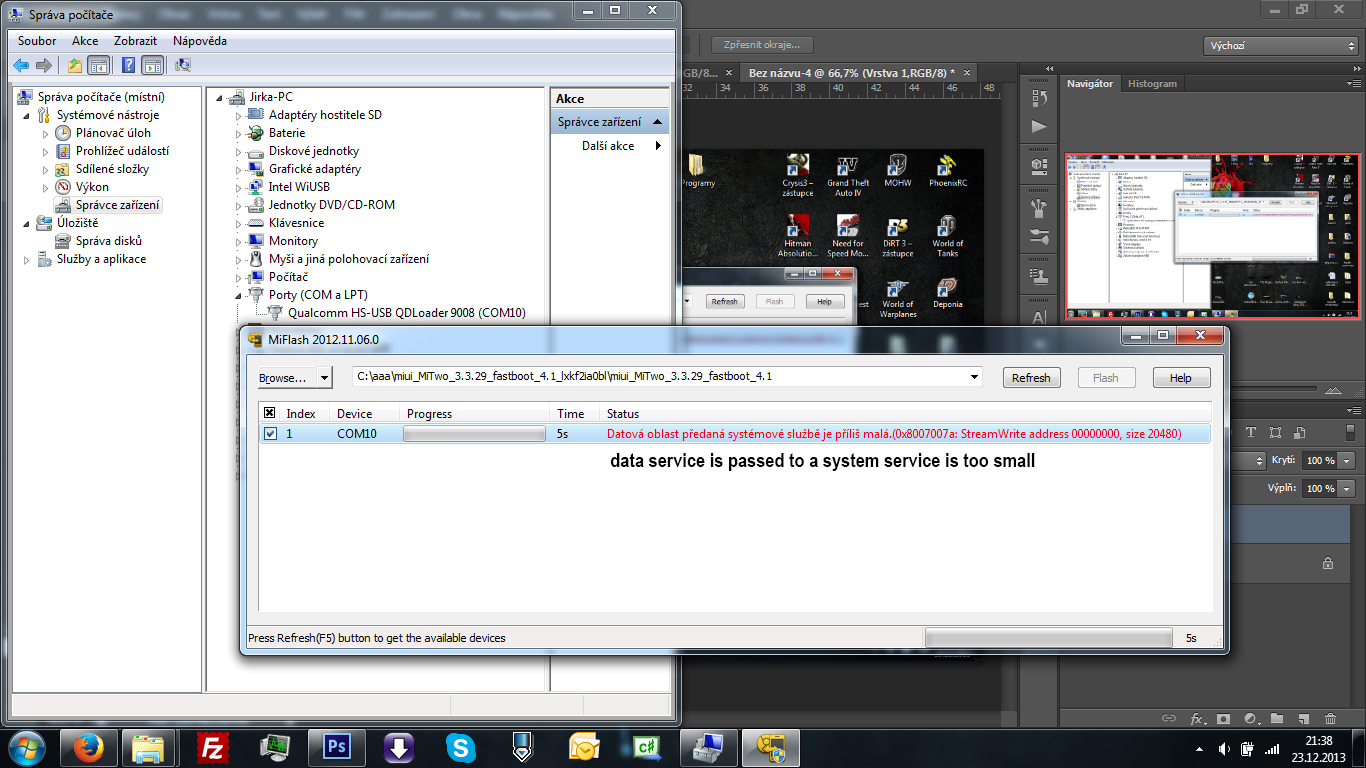

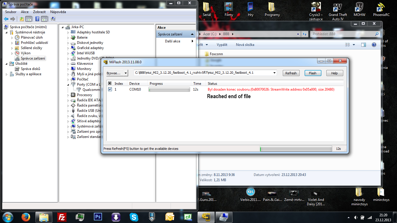

I can't flash my phone.
I used this tutorial: http://www.miui.com/thread-1130259-1-1.html
I removed the battery from phone. I connected phone to PC. I shorted circuit. I press button refresh and flash. MI-flash started flash phone. Mi-flash show me error 0x8007007a or 0x80070026.
When i connect phone to pc or charger, red LED diod flashing with battery or remove battery.
Could you help me, please
Thank you

i translate report and pictures
