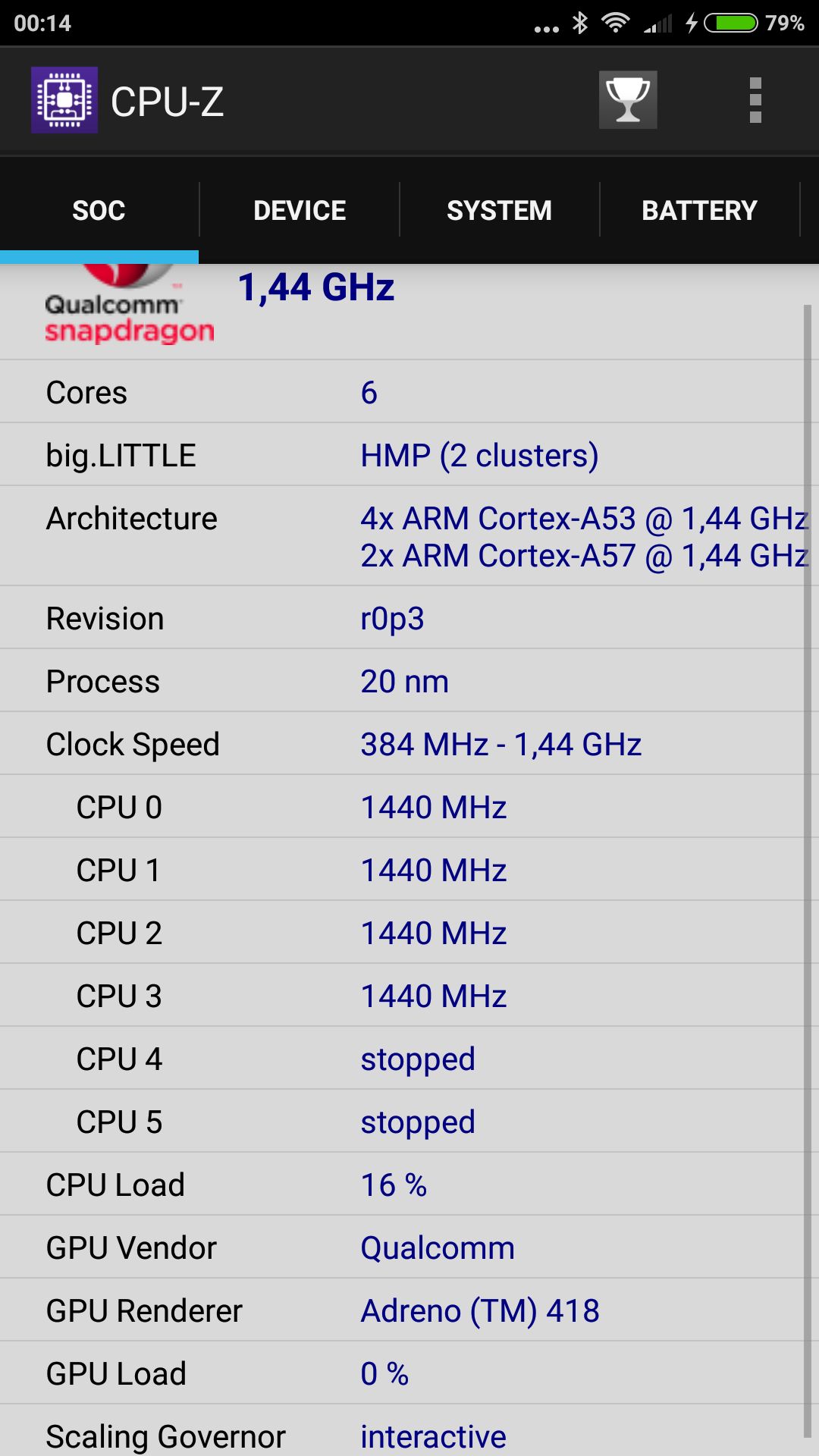

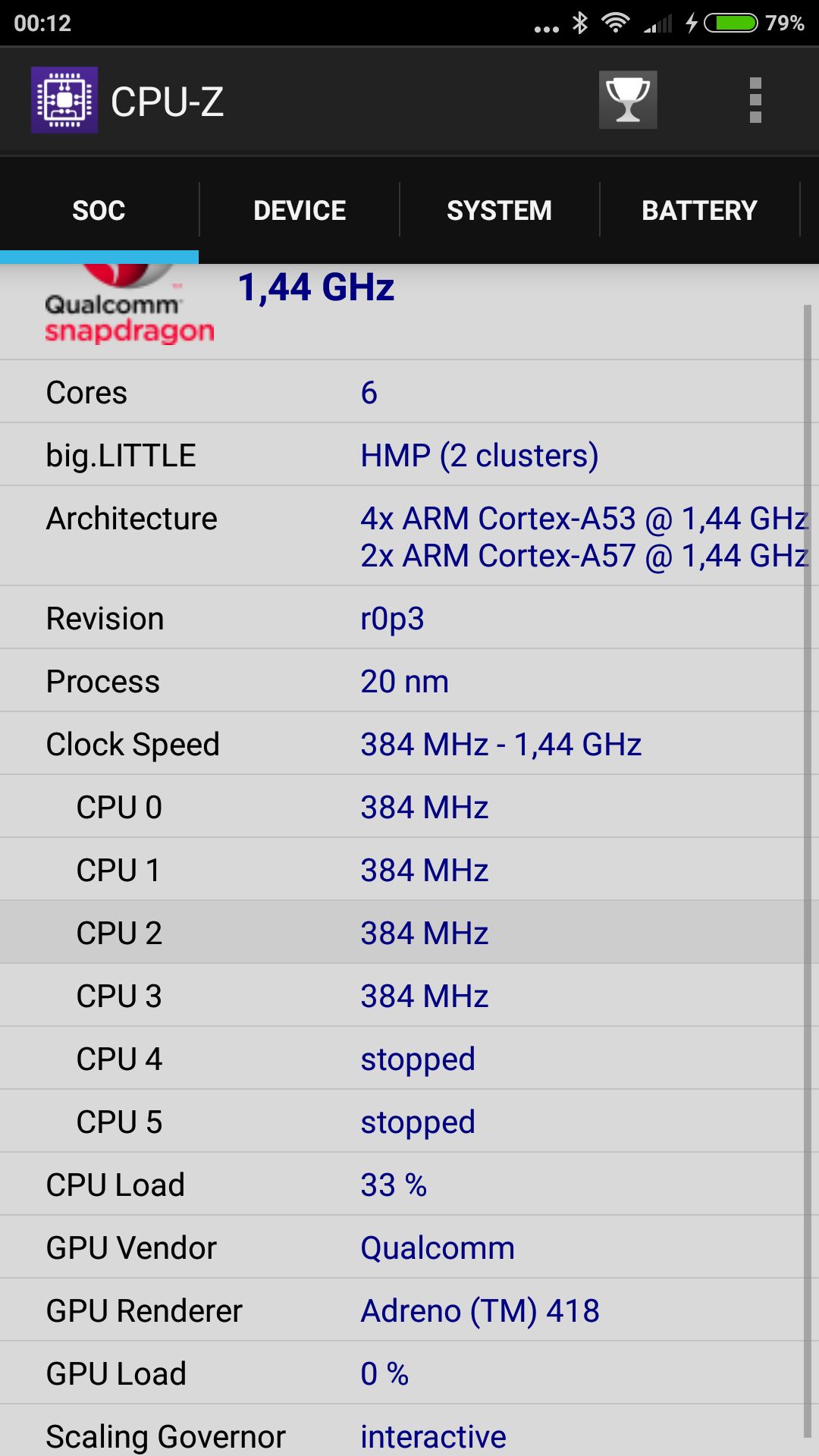

What about the cores? Can you check if the last two cores of the 808 stay turned off\stopped all the time? Even under heavy load? Because i notice that this is the case since beta 7.1.4. Just install Cpu-z and post a print here if you can :) thank you!
the pics are in idle state and in load state.. seems like cpu4 is off all the time.. not 3 too
Just like i said above! Since beta 7.1.4, the last two and most powerful cores of our phone were simple turned off by xiaomi! WTF? Seriously? Why the hell is that? It's because of the freaking overheating problem that this phone have? C'mon xiaomi are you ******* kidding me? You just need make adjustments\improvements to the freaking thermal engine, others phones with this same processor don't overheat like the mi 4c does and they perform very well!

And BTW the 4th core maybe locker atm but IT feels fast not sluggisch and i Just did a game and temperature was 32 degrees max, so item overall Nice build so far
To me it's strange if it's really locked! I kind of understand they doing it in the closed beta, but now? After releasing a public version? A version that people will start to complain because they are losing between 10 to 20k points in the antutu benchmark? And that they are losing the most two powerful cores that this phone have? Nah, i think that they are trying to fix the overheating s**t, but they are doing the wrong way i guess.

The battery is not lasting more because of an optimization done by the developers! It's lasting more because of the two last cores(the most powerful ones, the ones that eats more power) being shutdown all time!

Yeah dude i understand it, that it's the first "public" release and not the first release of nougat for the mi 4c! There was a closed beta you know that lasted for a month(give or take) and god knows how long it was already in development before that? You don't need to get so worked up because of a proven fact! And you have to admit it that it came pretty ****ed up, so ****ed up that it was suspended by xiaomi! If you appreciate something that faulty, indeed that is your problem. But you are talking about battery life here and you can't say that its good on nougat right now, because like you already know the two last cores are turned off all the time, these cores are the most powerful ones, the ones that eat more power, so you can't say anything about battery until this is fixed, because its misleading! Don't be a fanboy dude! Xiaomi it's only doing what they are suppose to do! Its their responsibility to gives us at least one android major update!
