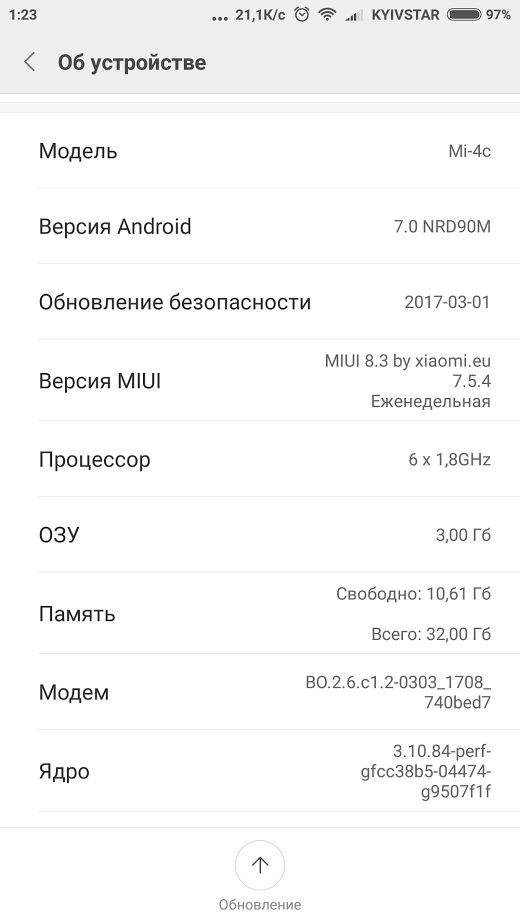

Mi-4c / 3 Gb / 32 Gb (2016)
was MIUI 8, Android 5.1, TWRP 2.7.8, MiuiPRO 7.1.12
1. get official XIAOMI unlock good to go... (got the permit after only 2 days)
2. change TWRP 3.0.2 (miui 7.5.4 mast be upped to /root of the phone before TWRP upgrade)
3. boot in recovery (new TWRP)
4. install new ROM for Nugat 7.5.4 (wipe caсhe, dalvik caсhe)
5. reboot to system
6. login MiAccount
7. with unlock tool proceed the unlock procedure (15 sec) ... AND voila UNDLOCKED
