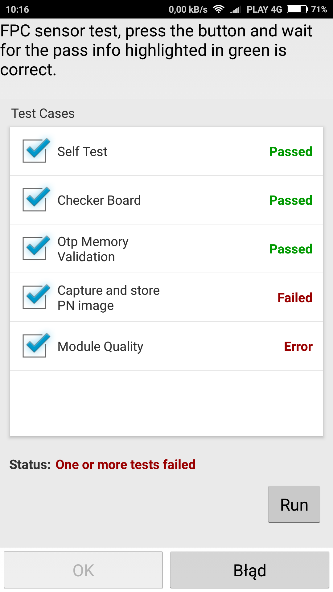

Can't add fingerprint to unlocki my device. When i trying to add fingerprint i got a message like this "Failed to add a fingerprint. try again". Whne i use a advanced diagnostic tool i got something like this:
I got mi6 from 2 days
MIUI version - Global 8.2 Stable (8.2.2.0) NCAMIEC
  • Screenshot_2017-07-29-10-16-56-773_com_miui_cit.png.5c76d42e47e87ff6e46bc35306ddb007.png
Similar issue here: I had already added 3 fingerprints and suddenly only my thumb worked, also only maybe 1 of 3 times. Flashed back to China Dev, everything ok again. Flashed back to Xiaomi.EU, it worked for like 12 hours, then issues again and only 1 finger gets detected. Sometimes not at all.
I went to hardware test too and it shows same error! I can provide logcat from failed unlock if you need it.

Still not working :/ I guess i wait for update to miui 9.
Hey man,
for me it started working again today! I did some workarounds yesterday: delete screen lock, also delete pin and everything. Let phone drain to 0% until it shuts off. Start it up like 10 times, you will see MI logo and it tries to boot and then shuts off because of low battery. After you do this a couple of times, only battery logo will flash. Repeat until you don't see battery logo and only LED lights up. So battery is completely empty. Let it sit with dead battery for 2-3 hours. Then, while off, charge it to 100%. Oh also I put some pressure on fingerprint sensor before turning it on.
I did every hardware test after, screen, flashlight, etc. Still got same result on the last FPC test as you did, but it's working perfectly again!! I think this last hardware test doesn't have to get passed. Now it's working 99% of the time with all 3 fingers I registered.
Maybe it was just luck, but this is what I did.

can't get to the point to make the LED flash. I make battery to 0% when i try to start up i get a flash of mi logo and battery trying turn on like 50 times and still dont get a LED only ;/
[EDIT]
Finally i go to the point when nothing shows, even the LED :p
[EDIT]
Try to let it sit for an hour or two, then recharge while off. When turning on, delete screen lock/fingerprint settings. Do all hardware tests on first page, use some pressure on fp sensor, but not too much. I don't know which of that helped, but now it works :)
Reactions: Hitardo
OOOOO YEAH ! Works perfect ! :D Thanks a lot for help :D am guessing the pressure on FP is the wey to fix it. first dont works but when i push a little harder it help :p
