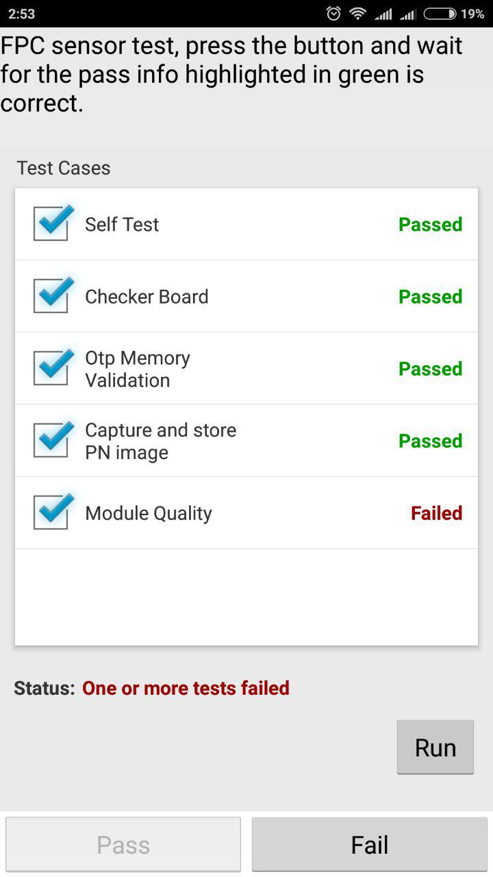

The fingerprint scanner was working as expected until today after I run the Hardware test in the Kernel. When I try to unlock the phone with my finger it work really rarely and only when my finger is 90 degrees.
How did you solve the problem?
photo_2017-10-01_14-29-09-jpg.16975
