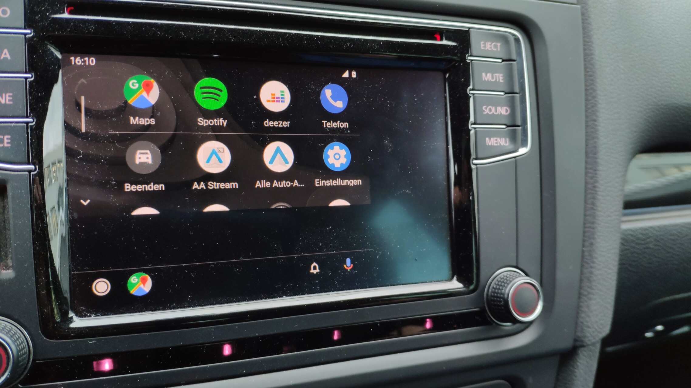

Flashed the old 20.1.9 and everything shows fine, not scaling issue
