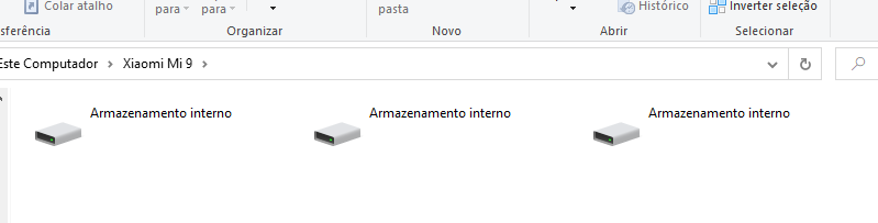

Not work man ..... i format data typing YES and connect usb to put xiaomi EU.ZIP, i can't copy the .zip file in to internal storage ...... when i copy nothing happns ..... when i enter in Windows > Mi 9 storage, i have 3 internal storage, is very crazy.......
Strange, I really think that the problem is the encryption, when you restart in TWRP ask for some password?
Use the Mauronofrio because supports the encryption, with me, when I forgot to format Data, I can't copy anything to the memory, was ony in Read Only and
the files and the folders is with strange characteres, be sure you are using the Mauronofrio Version.
Are you formating data and typing yes? Is really strange.
