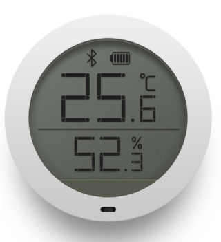

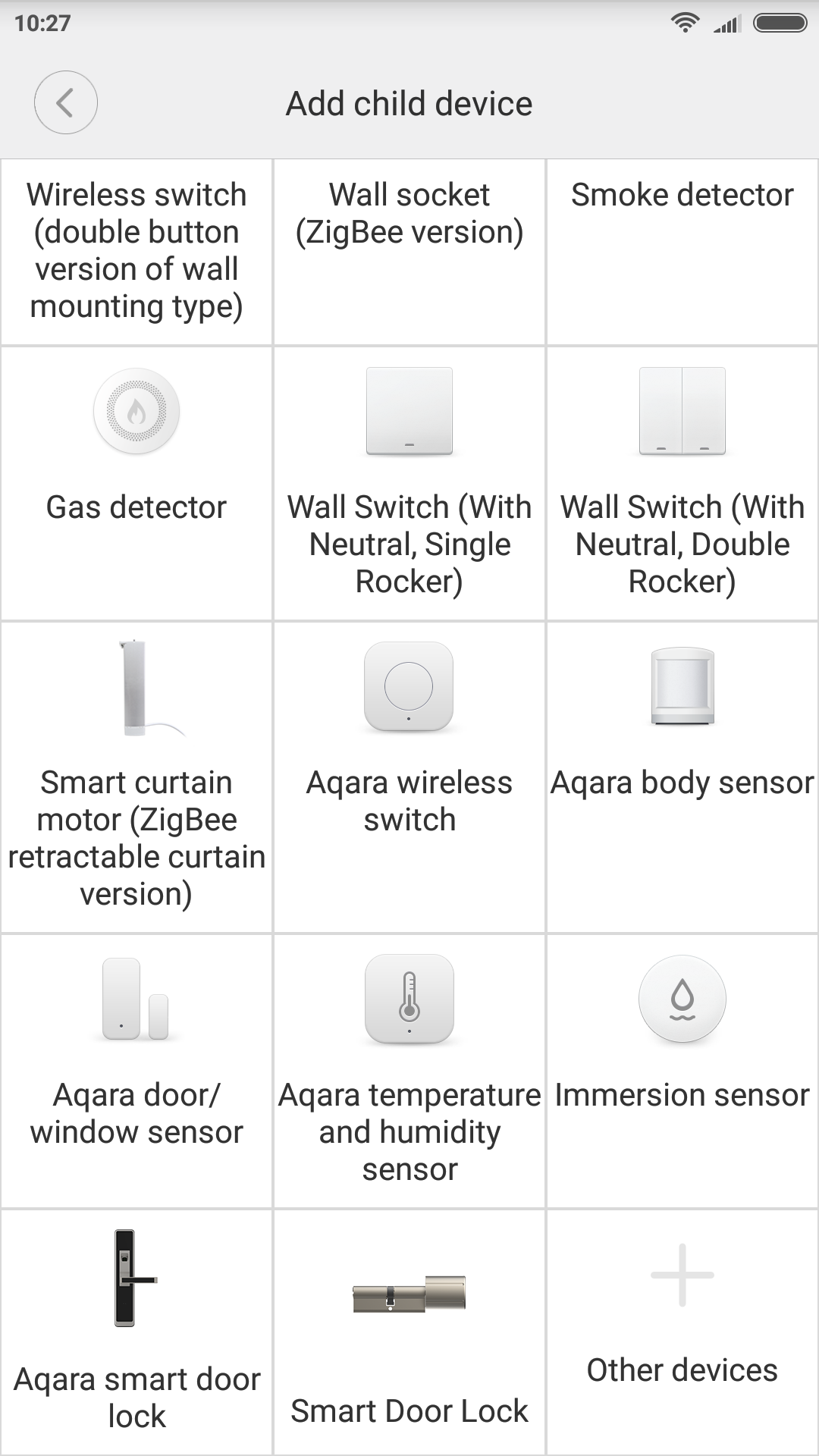

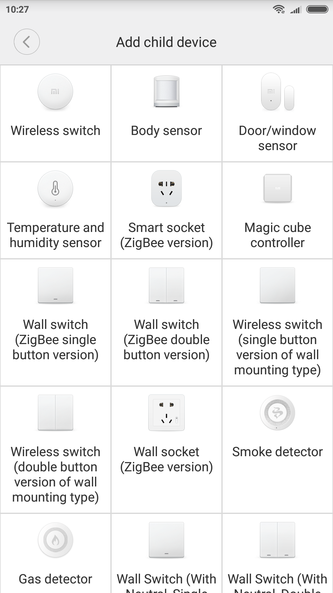

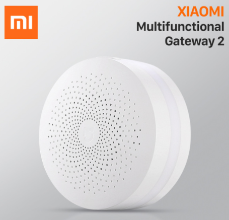

Hi. I bought mijia temperature sensor Screenshot_2.png and mijia control hub 2 Screenshot_1.png. I can not connect sensor to hub (sensor to phone application mihome connects normally). I have only these devices in "add device" tab UTB8rWGjxVfFXKJk43Ot760IPFXaj.png UTB8ewigx4HEXKJk43Je761eeXXaL.png . I tried to choose other types of sensors but with no luck. Can anyone help me with this?
Hello friend just change the server with chinese one and it will shows :) That is the only way to use.

Why? because each geographic server location holds a different configuration profile depending on which devices in that region are supported. It is by design to work this way.

Onother thing is if you wont to connect to gateway you need to turn phone bluetooth and you will find it.

Thank you for your help, I solved by switching to "US (Asia Server)" which supports all my devices and keep the interface friendly according to a western point of view.
What I learned is that the data, about my house and devices is stored separately on each server, and if you switch server you lose your settings and historical data.
