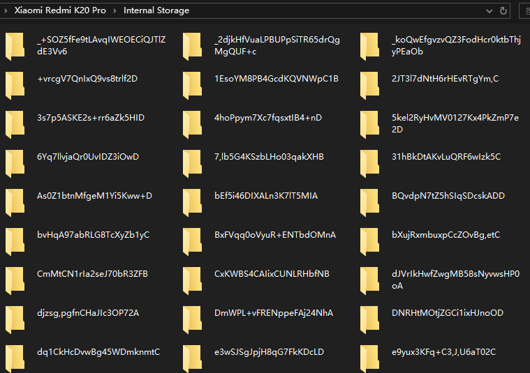

HELP! MY K20 RPO 10.4.6 dirty flash back to 10.3.15, after reboot, can not get into system, and auto back to twrp, and go into internal storage, and like the pic all random word file,and seems like the system gone! i cannot mtp copy file into phone and flash another rom! HELP!
Your device is encrypted. Use a TWRP which can handle that.
Thanks, I guess so, just replace the L.R.Team TWRP one have the decrypted funtional, but when get into TWRP, they dont show up the window ask me to put password, can you help me how to enter password?
No, sorry, maybe somebody else can help. On my Mi 9T I have no problem with this.
But you made a downgrade with dirty flash, that's not recommended. In worst case you need to do a format data again.
Thanks bro, after fomat the data then can boot into the sys, but just brand new phone again, lost all the data,
you need to use recovery which supports decryption. Try the below ones
It asks for lockscreen password after which its shows the files and folders in decrypted format. You can enter passcode or pattern that you have set for lockscreen.
Thanks bro, big help!
