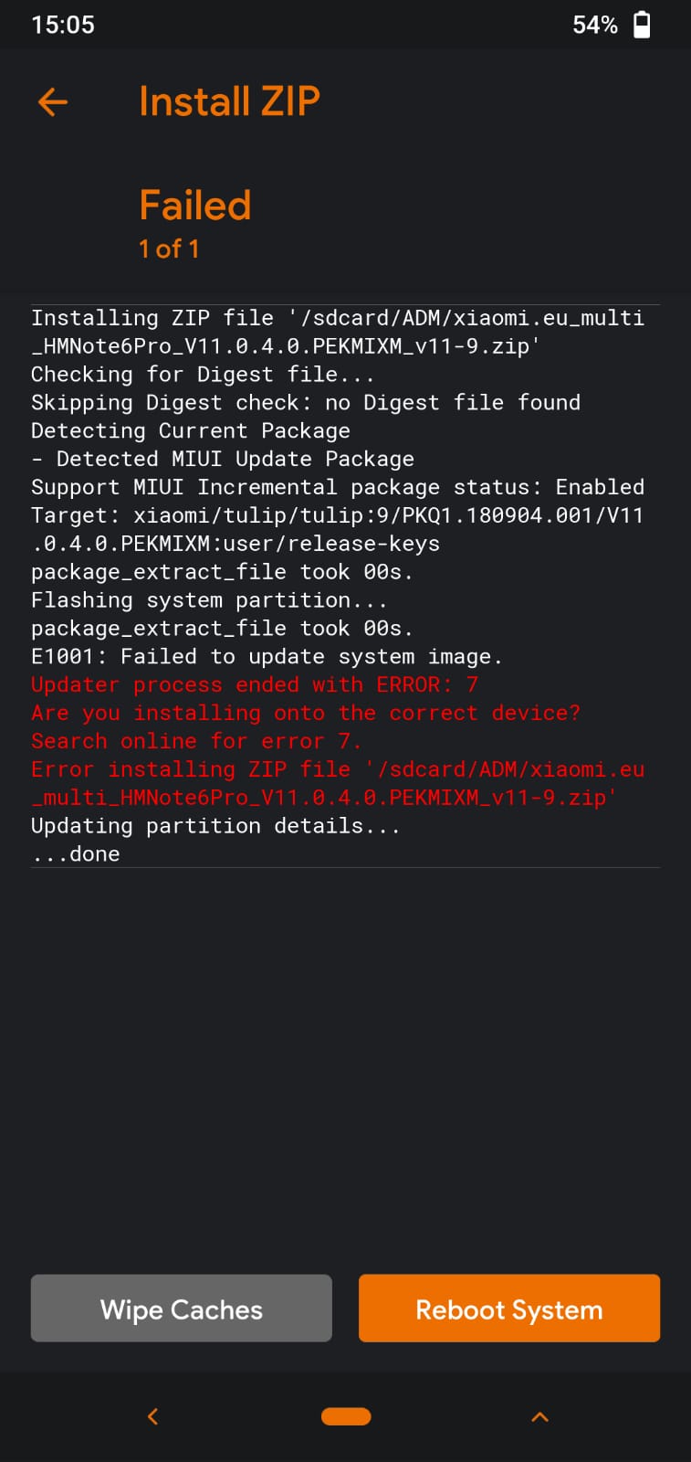

@ingbrzy tulip updating rom fails, after that phone goes bootloop. Flashing old build makes fine.
