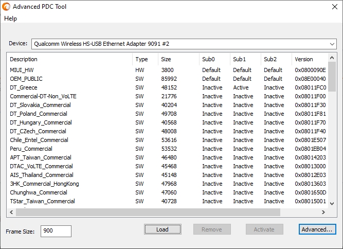

I tried that before, but failed because of the Modemprofile. I just couldn't find that "DT-Greece". Today downloaded the latest Qualcomm Drivers plus the latest QPST-Tool. So I managed to get DT-Greece active. Done all the magic with activationcodes and so on.

I couldn't try it yet but I see that you didn't activate the sub0 option. Other problem could be that the DT_Grece profile doesn't suit for your carrier so need to try with another of the profiles
Yes, DT_Greece should be correct as mentioned in the linked XDA-Thread. Meanwhile I activated the profile on Sub0 too. What has, as expected, no effect. - Sim is placed in second (SUB1).

Well I tried but couldn't get the phone recognized by QPST tool

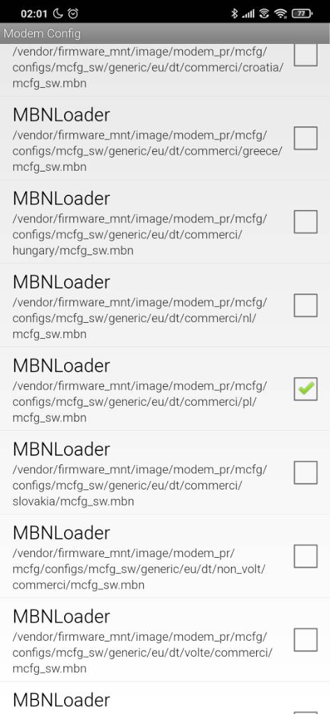

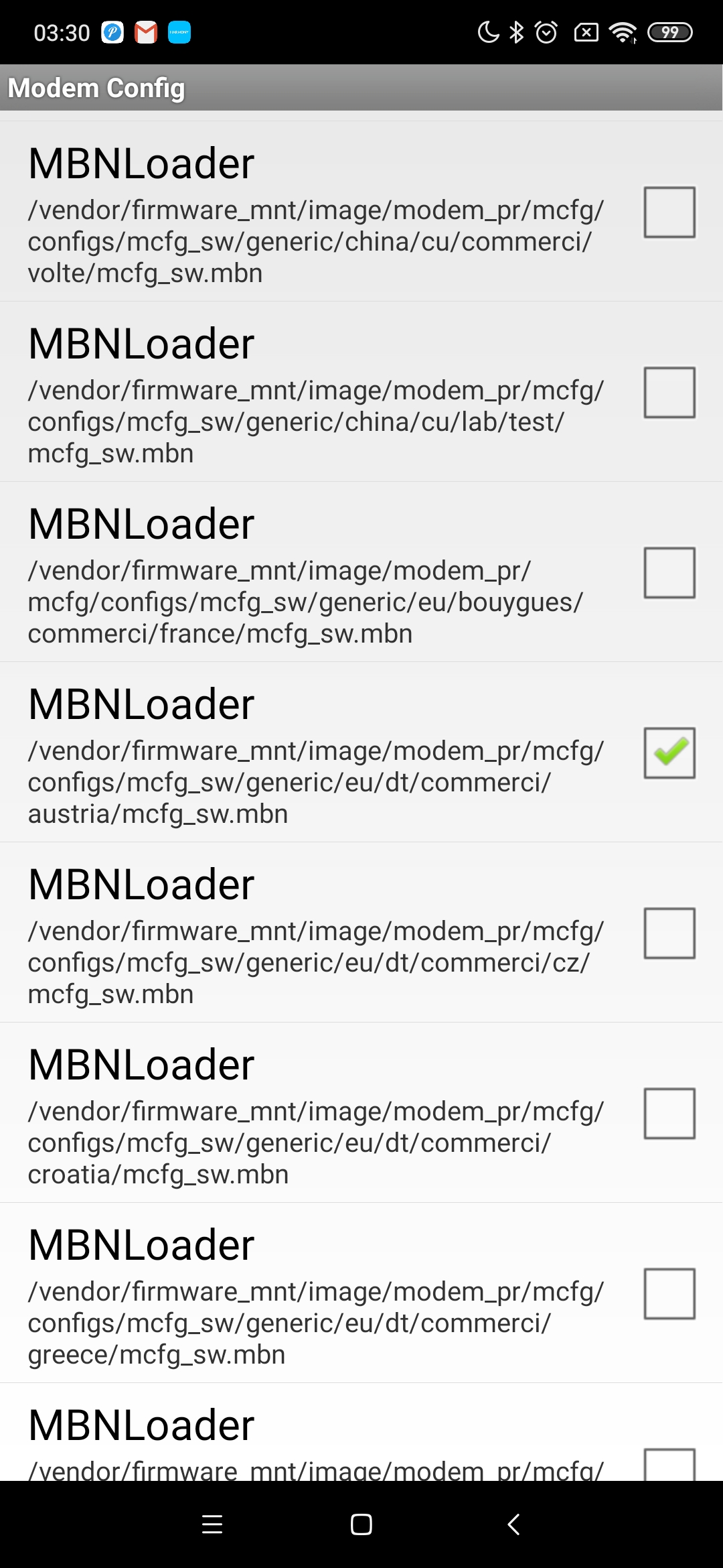

Btw. this can be done much easier directly on the device with the app "Activity Manager 3.0.0" (not on Google Play, search for the apk)
Install the app, search for "modem config", open it and select your desired modem configuration file.

Thanks for that info, you have saved me a lot of work .
I have tried the activity manager method without success.
Well I decided to try again with the activity manager and playing with it I ended selecting a modem config and the VoWifi just got enable an working...
I will try it further but for now it works

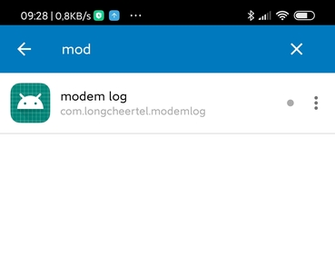

No luck with that. Within Activity Manager, I can't find/there is no "modem config". - Don't know why!

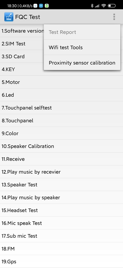

Then you might have to go the way with the Qualcomm PDC tool.

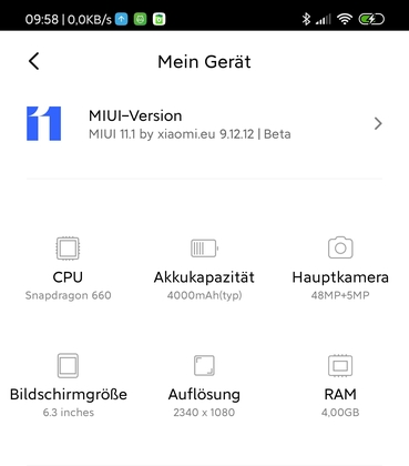

Or, try the following:
Mein Gerät > Alle Spezifikationen > 5 x click on "Kernel"
CIT Tool opens.
Click on the 3 dots in the right top corner and select "weitere Tools".
Then "MODEM Testtools" and there (should be the last in the list) "MBN-Konfigurations-, Lade- und Aktivierungswerkzeug".

Nope, nothing there in my Lavender. - Never mind!
